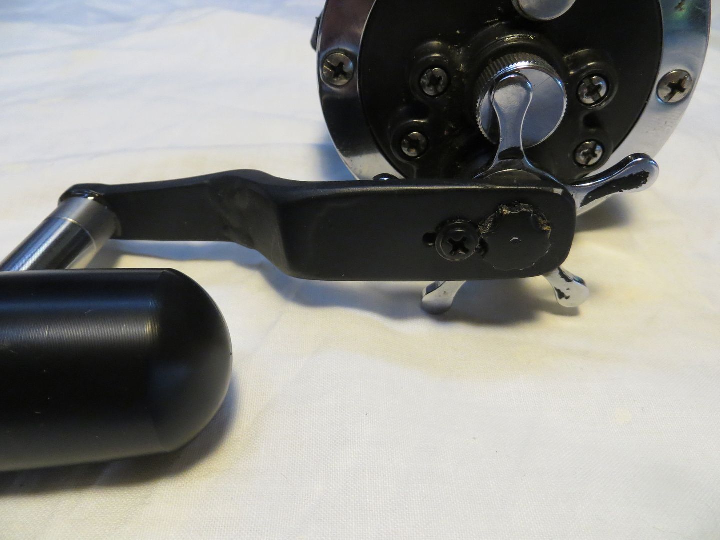

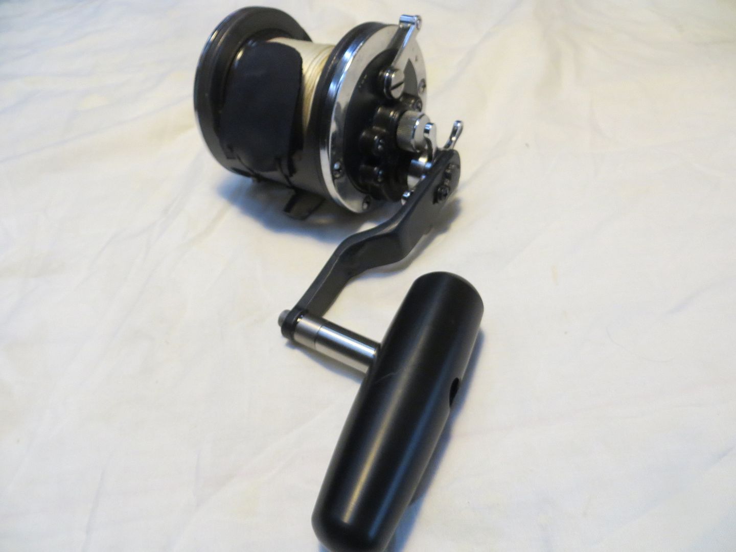

 No it's not a "salt water" reel but I'm going to use it anyway. I got a used Daiwa PS2 5B on ebay, used to be one of my fav reels in the day. The problem is the line is not wrapping clean and even, it's bunched randomly in spots. I tried walking out the line, tightened the drag so it's not dragging. I cant see the line guide skipping or hanging, maybe looks a little loose. I was trying to wrap 12lb mono as a backing then 20lb braid. Any thoughts what to check for? I've had a least a dozen baitcasters over the yrs, never had this. ???

 Took it all apart, very clean. Greased the level wind gear that the guide rides on. I think maybe the lil end cap that holds tension on the blade that runs in the level wind gear was loose. Snugged it all up and loaded w 12lb, cast and retrieves fine now, I don't like that cap w just a tiny flat disk in there for tension but it works.
