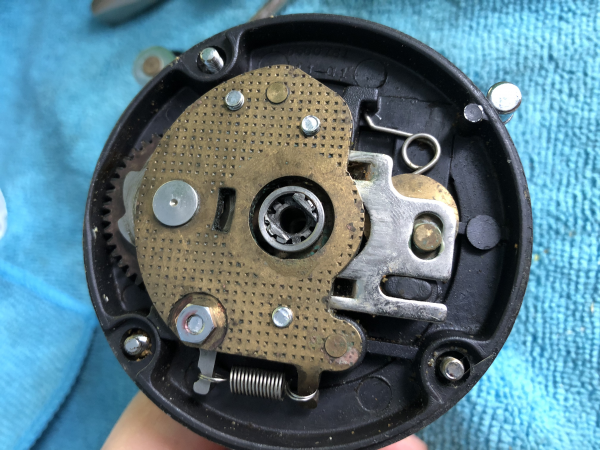

Good Day, thanks for information! I found interesting type of magnets inside
Porthos
Your photo of the magnets (which matches mine) is additional evidence that the default factory config is as shown. As positioned, regardless of setting 0 or 10, the magnets' fields are always affecting the steel cup on the spool...they can never be in an "off" position for unrestrained freespool.

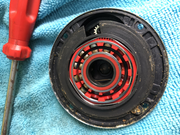

after adding reel oil to bearing and gear. the reeling still tight.
Im thinking to convert to  monomag like PMR.
Porthos
Quote from: Riy2018 on November 10, 2018, 02:56:41 AM
Did you try loosening the tension cap on right side plate?
Riy2018
Yes! Thank you Sir. it worked. I have tightened it. after loosening it worked flawless. thank you,
