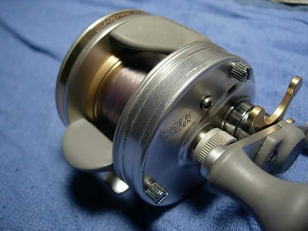

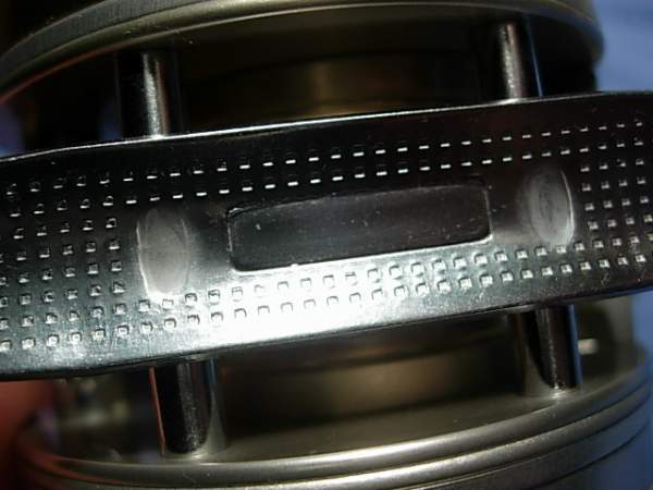

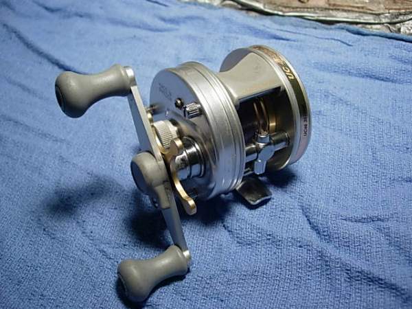

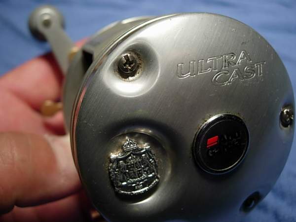

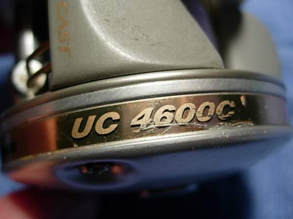

ambassaduer 4600 ultra cast $100
a guy shipped an abu 4600 ultra cast to me for service, but it had a broken frame. i told him that the frame would be $45 and that a new reel was $110, so he said "keep it!" i just finished fixing it up with a new frame, carbontex drag and a bearing service. the stock drag washers were replaced with grease carbontex. the bearings were pulled out, the shields were removed, they were cleaned, lubed with tsi 301 and reinstalled open. when you spin the handle and then kick it into free spool, the leveler travels 12 times across the length of the spool before coming to a stop. nice little reel. it's very smooth and has great freespool. the price is $100 with shipping included.
