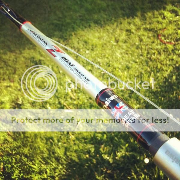

Yesterday I recieved my new Team Daiwa Z-Boat 30LB Class rod - which feels perfect with the LX 6/3, now with the new T-Bar handle installed.
