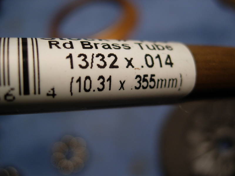

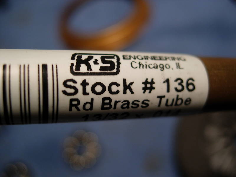

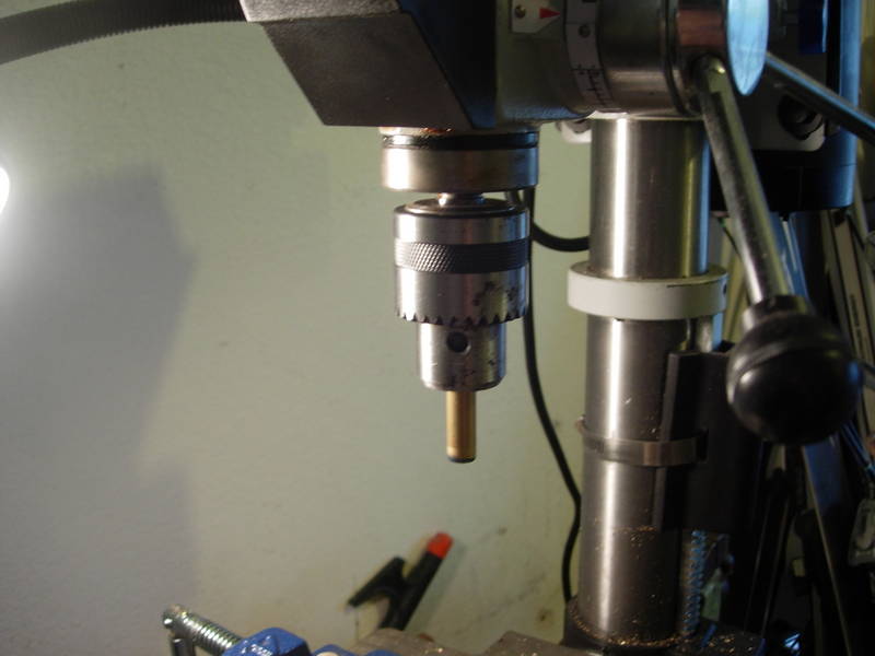

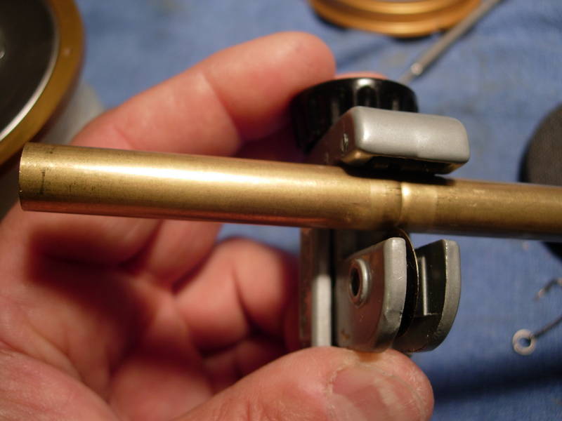

something new that i've been doing, starting in the summer of 2008, is cutting bearing sleeves.  i've been buying thin walled brass tubing from the local hobby shop and cutting them down to fit in between the bearings.  the increased freespool has been dramatic.  here's the tubing needed for the penn international 30sw

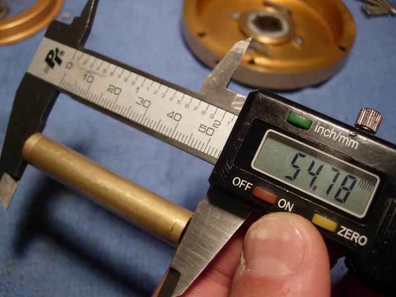

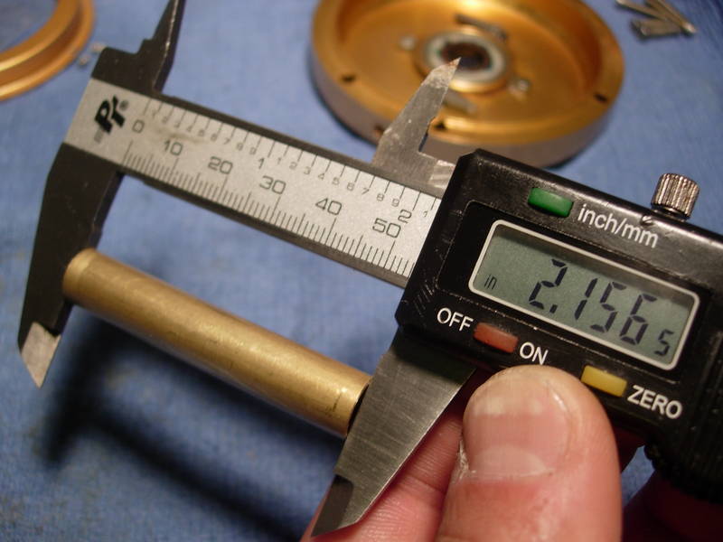

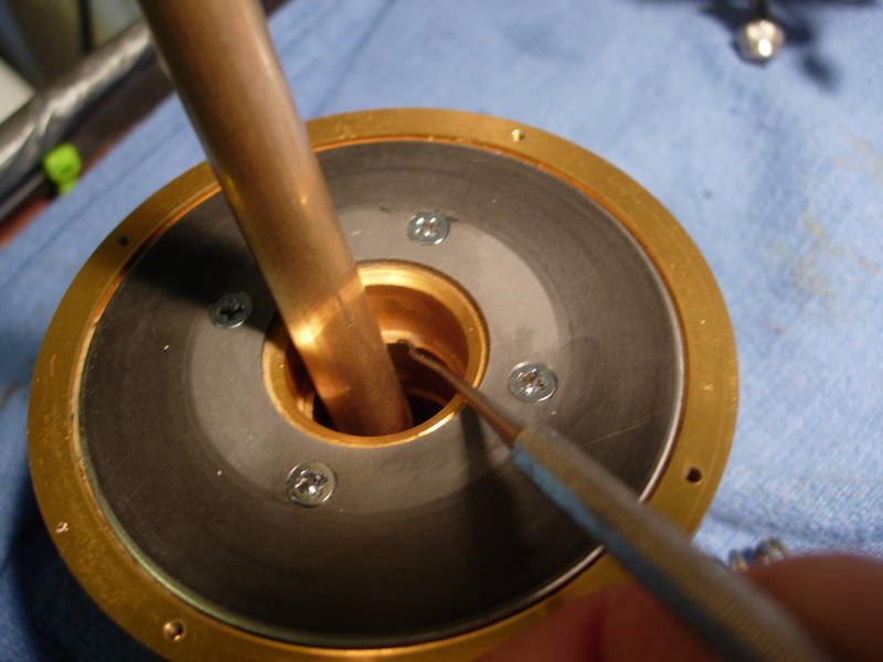

the whole process is relatively simple.  i get a quick measurement of the length needed and cut it with a tubing cutter.

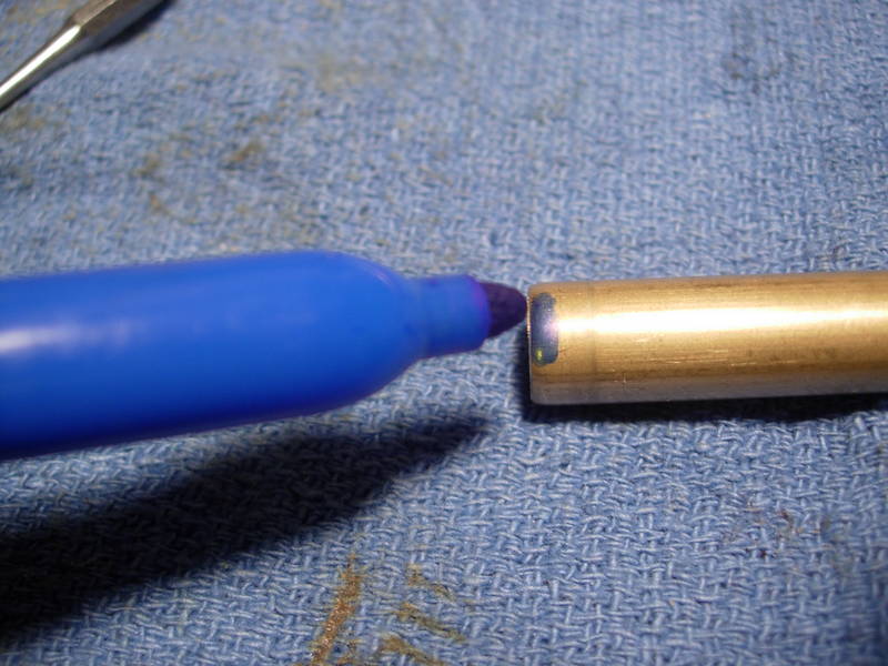

then i re-measure the lengh and mark the amount of metal that needs to come off.

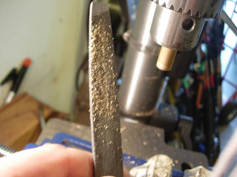

the sleeve is then placed in the chuck of the drill press.  even a hand held drill with a half inch chuck would work.
a standard mill bastard file will shave off 5 to 10 thousanths of an inch with every stroke, depending on how sharp the file is and how hard you lean on it.  after a few tries, you will get the feel for it.  plan on having to do this a few times before you get it right.
ideally, you want zero load and zero endplay.  actually, if you cut it too short, you may as well start over because the bearing sleeve will not work at all.  if it's too long, the spool can move around while in free and you may note that the spool stops when you roll it to the right.  you want to be right on the money, or not more than 10 thousanths long.  this one was perfect.  with just the bearings and sleeve in place, you should be able to push in on one bearing and feel just the slightest amount of pressure on the other.  it you can push in on one bearing and actually MOVE the other bearing completely, the sleeve is way too long.

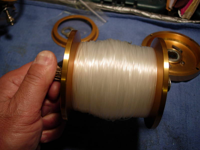

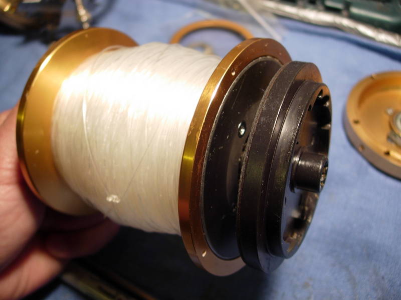

here is what the spool shaft assembly looks like with the bearing sleeve in place.
to check the function of the bearings and bearing sleeve, first place the spool shaft assembly in the spool and give it a spin.  you should get about 30 seconds of freespool.
now place the drive plate (key #117) on, press only half way to put pressure on the left side bearing spring (key #41) and spin it again.  if you get the same amount of freespool, then you know that there is no axial load on the bearings and it works.  again, make sure the bearing sleeve is not too long.
