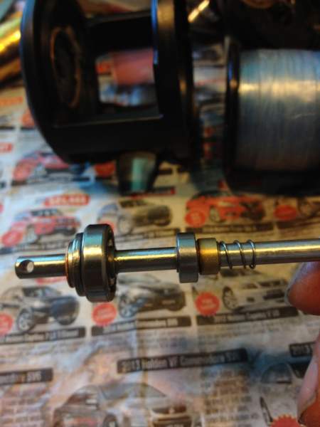

I forgot the take a picture of the dog upgrade, now it has a clicking dog and its always engaged no more worries on nuckle buster anymore.
the new dog and spring are not noticiable on this pic but I pointed out with a red arrow where the spring is holding the trinidad DC dog.
before closing the reel I also modified the nylon gear on the left side of the spool, I just grinded the teeth off to make it round and avoid contact with the rest of the plastic gears on the left plate, this mod increase the free spool tremendously
not perfect it looks really good and served its purpose
