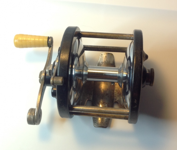

I wanted an original style 190 to fish with and got this one because it was cheap and I liked the old wooden knob.  Maybe you get what you pay for.
When it arrived, the first thing I noticed was that someone had painted all the external metal with metallic-like paint and the bakelite was painted black.  Maybe a kid did it.  That's what I would have done with an old second hand reel when I was a kid.
I like to clean up the inside and keep the honest external wear, patina and baked-on grunge.  But, that paint had to go.  It was disassembled and put in a sonic cleaner with Simple Green while I tried to figure out if paint striper would dissolve bakelite.  I was worried about losing detail in the embossed tail plate. Paint striper does not dissolve bakelite, but the striper was not needed because all the paint just fell off in the sonic cleaner. It was amazing.
But, with the axel grease gone I found that there is a chunk of head plate broken off by the eccentric.  But, the eccentric still works... for now.  That's pretty amazing too.  I also realized that the four screws on the stand are probably replacements.  They have a modern cut and more chrome in the alloy.
I like the looks of crusty corrosion.
It works fine.  I should have photographed the spring under the cast control knob because it is really beefy and has to be cranked way down to slow the spool enough to cast.  Can't wait to go fishing.

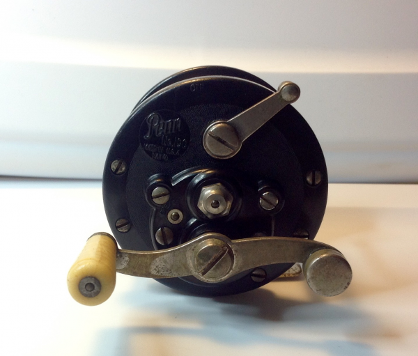

Tbrom
I picked up an older 190. It is not a prom queen by any stretch. I doubt I will ever fish it but I would like to get the spool that most likely came with it to make it period correct. I am assuming it should be a plastic spool? I am guessing it's a 1940s reel. Thanks Tim
