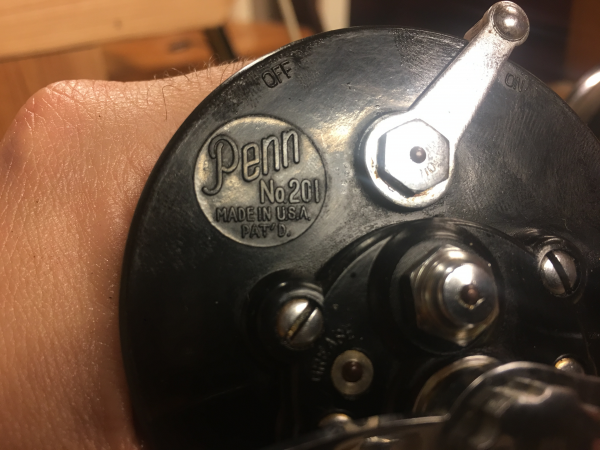

What is the small lever on my Squidder 140L for and when casting what position should it be on "Off or ON"?  Thanks RJ
Quote from: mccandrj on October 08, 2016, 08:51:45 PM
That small lever disengages the anti reverse dog to turn the reel into direct drive, also know as knuckle buster, cause handle will turn as it lets out line, or as a fish takes line.
You definitely do not want the handle spinning while casting.
 Ted
mccandrj
QuoteSo, the setting would be OFF?
No, the setting should be on.
mccandrj
When you disengage the freespool lever the spool spins independently from the pinion (only the spool and bearings will be in motion)  and will do so for casting regardless of the position of the smaller eccentric lever, which engages the antireverse mechanism (a dog that engages a ratchet when "on"), so in the "off" position it does not do so and the handle can be cranked in reverse to let line out. You want the antireverse engaged when you cast (I presume) so that you will have drag available immediately after the cast. With the A/R disengaged, as Ted said, you will have a knucklebuster, which got that name for a reason :).
