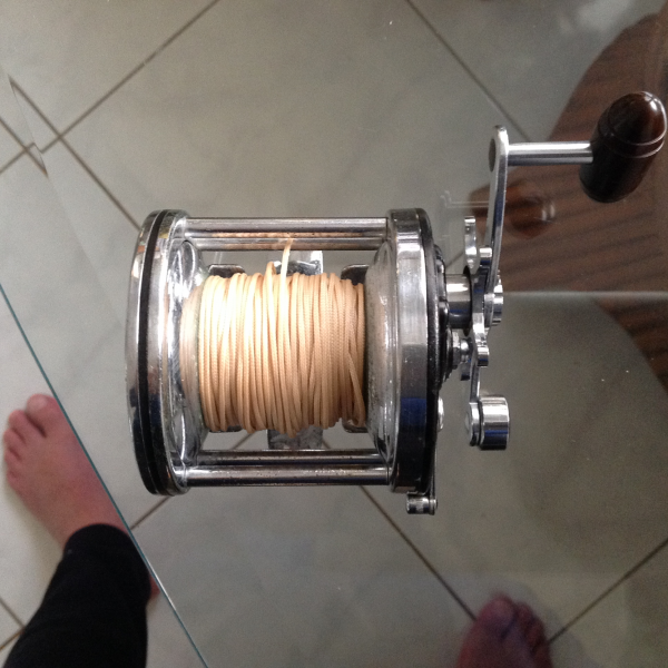

A 1939 Silver Beach 97. Will post questions as I start to go through it

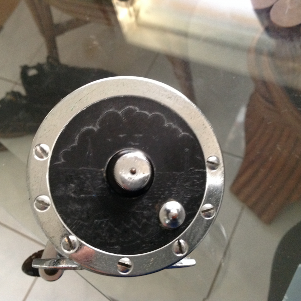

Externally: tailplate w/ hershy click button, picture plate has a surfishin guy below a sailboat on the horizon, lighthouse on the left side. Arbor with a line- knob in the center. Handle w/ short , fat, no coin edge counter-weight, dark brown torpedo knob. No part numbers as expected. Internally, so far, chromed b. Plate, eccentric and e. Jack. No ring on top a the pinion-darn!. This looks like a strong stock reel, would a 13-500 jigmaster pinion(w/a ring) fit?

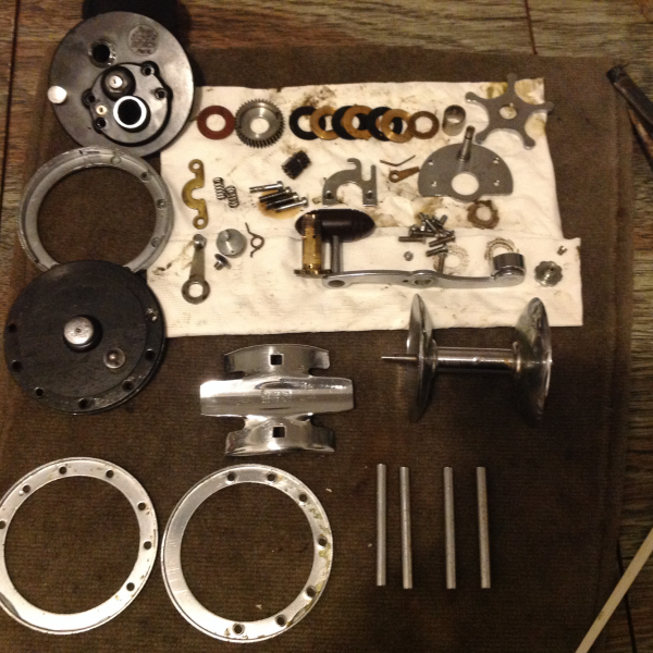

Upon opening this'n, I found: chromed bridge plate with the older narrow diameter stud; chromed E. Jack & eccentric, but not the yolk?; brass gear sleeve with 2 pin holes (one slightly higher than the other) -never seen that before in a factory one; and a nice steel gear.
This one's in good condition, very little chrome loss. The leather drag washers gotta go, but I'll probably limit it to that, as changing the bridge plate to one with a newer-thicker stud(for sleeve, etc. upgrades)would be difficult. It's that funny sized Longbeach 60(no numbers on the plate)bridge and finding one with the thicker stud is hard.

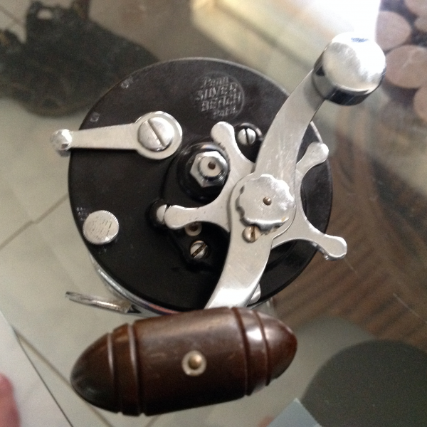

One of my favorite Penn reels. Love the 1938 Model 97. It came with the old handle style only for the 1938 model year.
#11
Wow, the handle-knob on that '38 is somethin else. I like yours better, wanna trade? Kidding. Does the '38 have a waffel style clicker?
Yes, it should have a waffle click... I think the hershey showed up in '39.
Quote from: Gfish on February 04, 2018, 04:02:14 PM
   The '38 handle knob is my favorite...such a cool look. 8)
Here is the tail plate for the 1938 Silver Beach.
