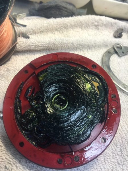

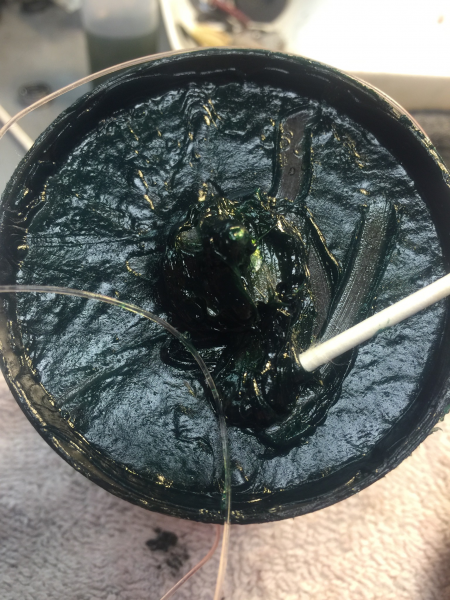

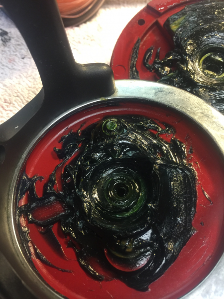

Check out this humble 113H 4/0 reel. Ready for a quick service.

Ye gods!! Did some madman lube that poor reel from a tar boiler??  :o  >:(

I bet it was Quiet. ;D
Not only that, I can't imagine what happens when a tuna, cobia, shark or some other long running hard pulling fish combined with the sun heats up that grease and the spool starts spinning! :o;D

Amazing Keith! Bet you couldn't hear the clicker on that bad boy. I guess you can't get any water intrusion if there's no room for it.

Sheesh, I looked at the first picture and couldn't tell which side plate I was looking at...

Careful, Keith --
You could pull a perfectly preserved dinosaur fossil out of that sideplate -- sort of like the La Brea Tar Pits in LA.
These are the ones I charge double for -- and that is not enough, because it will contaminate permanently a lot of your cleaning equipment -- if not really careful.  Lots of scrapers, Q-Tips, lacquer thinner or kerosene, rags, etc, etc.
Looks like trailer axle grease.
That stuff is nasty.
Show us when you are done -- I bet it will turn out beautifully in your hands.
I don't know how side plates react in gasoline but that would get a long soak and good brushing before I took it down any further.
Q Tips, paper towels, and Gunk heavy duty cleaner diluted with Kerosene. Gloves and gloves...
The left side screws were greased while the right side screws were not. None under the rings.
I think Aiala got it right. They took the left side off and used a grease gun to fill it up..!!
I had an Oh my God moment when I took it apart.

When I get in reels like that I charge extra -- and if it's that white lithium stuff, I tell them they need to clean it off before I'll service their reel. Not every customer is happy to hear this but most understand. Some tell me that their wife or someone else did it. Really.

I got a reel like that few months ago, it was a penn international 50II, when I opened the reel up it smelled like an old truck axle, the reason? the owner used grease from his car to service the reel, no wonder why the dog never engaged, it was stuck inside of all the tacky grease.
but on a second sight yours is worst LOL.
