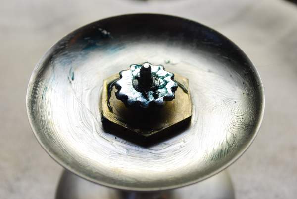

Can't tell you the year on these, but here is a metal two-piece spool, somewhat similar to the plastic spool in design:
mhc
A 29M-250 spool for a 250 surfmaster or 500 pulled apart;
The arbor / spindle is one piece. Here is a longbeach 66 spool arbor that Chris (Rothmar2) turned down to 501 width to make a 66N
Thanks for posting those pics Mike, sorry I couldn't remember it was you.
Thanks, Mike. This is becoming a fun thread. Are the flanges threaded also, or is it just the nuts on either end that hold them in place?
Sid
mhc
The flanges are a push tight fit (some not as tight as others) held in place by the nuts you can see at each end. I think the polished flanges are are chromed brass & the ones with a 'brushed' finish are stainless.
A chromed brass flange pulled off the arbor of a 500 spool;
And a 500 spool with 'brushed' stainless flanges;
