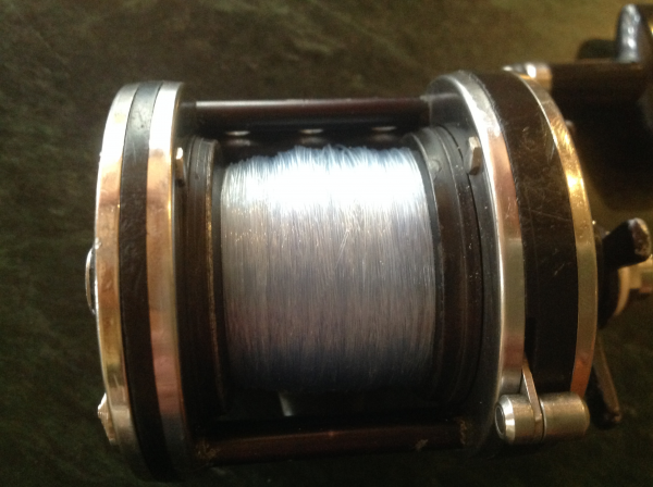

I took the side plates off, loosened the rings and tightened slowly and it didn't improve things. It is worst at the bottom.  I noticed that the spool is not centered left to right and seems to be off by nearly a 1/16. Here are some pics.

What Bryan said^ looks like you might be missing a spacer ring on the right bearing cup. That's that plastic ring that looks like it's broken/split. Different colors are different thickness you'll have to experiment to find the right one. I think mine are white on p220f. Sometimes you can substitute an o ring to get the desired spacing. Looks like an original p four stack, nice reel. Spool just needs to be shifted to the right a little.

If it is not the spacer ring then there may be a shim washer under the bearing on the handle side. Hope it is that simple for you. Most of the time the shim washers are under the left side bearing.

Orange might be the right one for your reel. They are determined at the factory. I guess I was getting a little ahead of myself, check under the bearings like Newell Nut said for thin curved shims (spacers). Move those to the left side bearing cup if in the right side cup. This will move the spool to the right. If you save bearing shields, you could use those for shims if the right size is found. Just hammer them flat it works.

Under the right bearing cap was a black flat washer. I took that out and it is improved. 0n the left side, should there be an O ring or a plastic spacer? Mine has what looks and feels like a hardened O ring.
