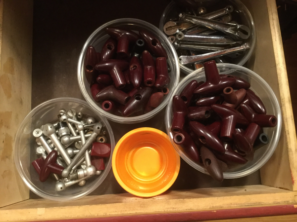

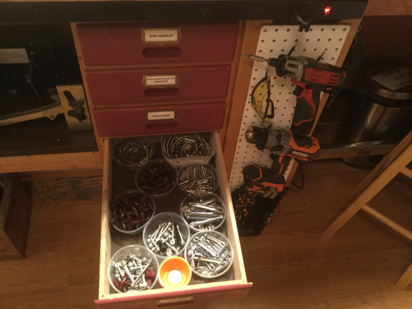

I never get tired of seeing pictures of your parts inventory Fred.
