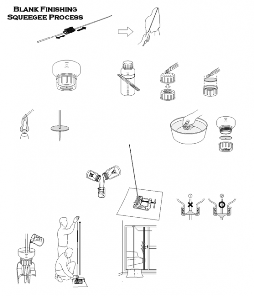

One of the easier ways to finish a blank with far less fumes is to squeegee the finish. It takes some trial and error to get it right but you are using way less finish and a more even coat. Still, if using what you are for finish, I'd do this in a garage or another area where you are not letting the fumes find others.
Dave

thanks Dave,
that looks like a nice idea, I read that some guys use that same method and using thread wraping epoxic because it leaves a really thin coat.
I would have to look for the materials and parts to try it too

thanks Dave,
I've done that with limited success.   Never been able to figure out why it sometimes does not work and leave uncovered patches. (asif there was grease on the blank at spots)
