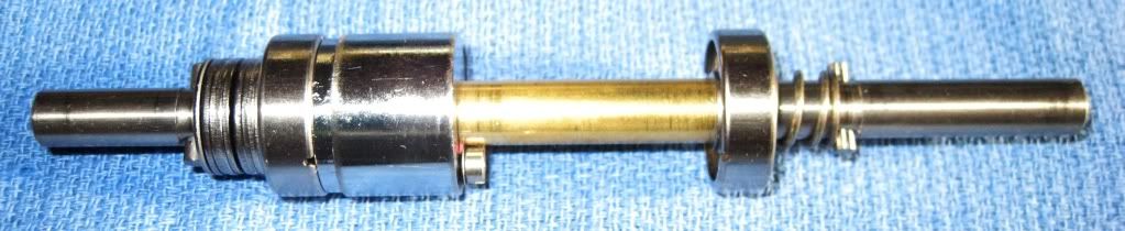

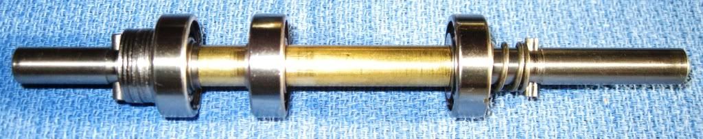

3. spool bearing from a TN drive shaft?  I read that the bushing sometimes wears the spool shaft or corrodes into place.

Decided to pull my new Torium 20 (poor man's Trini) down and check Shimano's greasing before I commence fishing with it. There was a dearth of grease in the reel except for some spots on the gears and spool spindle. The drag washers were dry although  the bearings appeared to be oiled. I had intended fitting a ball bearing in the frame in way of the drive shaft. Changed my mind when I discovered a nice little bronze bush there and decided that it would be ok for the fishing I do  having had ball bearing issues here in Trinidads.

Rather swap out the bushing for the bearing. The bushing has a habit of corroding and getting stuck in the frame and also wears the drive shaft out. The bearing doesn't give problems in my experience
