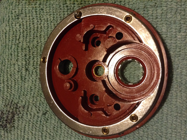

#9
  You may have noticed in my posts I use Bryan's under gear set often to make a 4-stack drag setup.
It's a great way to grab a few more usable pounds of drag without over stressing a reel with stock framework. I've even used it in a 113H with a 5-stack for 6 friction surfaces. The first pic shows 2 types of stock Penn under gear washers above Bryan's stainless steel/carbontex set. Sometimes this under gear set will push out the main gear a few thousandths causing rub on the side plate. The reason for this is the stock Penn undergear washer is .032-.034 and Bryan's set is .040...each washer contributing .020. I know 8 thousandths  doesn't sound like much...but it's tight inside that gear housing. The second pic shows how similar the two systems are in thickness. The third pic shows how the gear housing is "terraced". These are the areas the main gear, the drag washers, and the spring washer all fit into. Any one or all could be scraping if the main gear is pushed out a bit. It's easy to identify where the rub is...now you need to remove a little material. I do mean a little...just skim off a shave. I'll say it now...if you don't have a Dremel tool...get one. The fourth pic shows the type bit I use. Sometimes just removing the spring washer will take care of the rub. If you don't like the feel of the drag with it removed...just move it to between the spacer and the star. 8)
P.S. I forgot to mention shimming the gear sleeve will also sometimes contribute to side plate/gear rubbing, as it moves the gear out in the same way. No sweat though, skimming a few thousandths off the side plate is worth the reward of a solid feeling handle and more usable power.
Some might say the washer for under the gear should perform as a bearing, not adding drag. this gives the best performance. Clutch assembly should not be combined with that washer for under the gear.
Removing a Belleville or a wavy washer ( both spring washers) from the top of the drag stack will create a possibility for the star to back up on its own when you don't want it to.
Of course you set your reels as you like, this is just my opinion and also what I do on my personal reels.

Hi Mo
With regard to your first photo, how can a keyed washer fit on the gear sleeve under the gear when the sleeve is round at this area?
Forgive me if I am understanding this incorrectly.
Basto
mhc
Hi Greg, Alan T had some '2nd generation' gear sleeves made with the flat extended to the bottom of the sleeve to accommodate the under gear keyed washer. http://alantani.com/index.php?topic=13041.0
