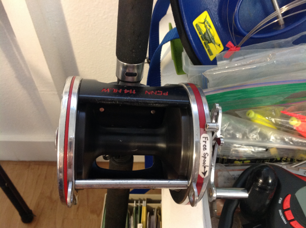

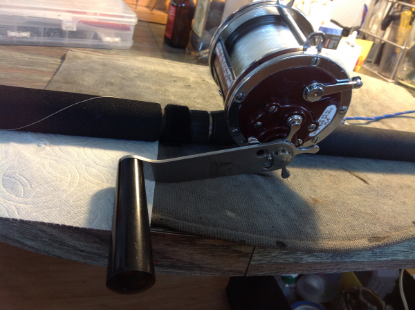

Troutman561, here's my 114HL. Wanted to show you an example of serious winch type handle for the kind of fishing you described. Mine's got a double ss dog upgrade thanks to Sal. I did it and it really wasn't that hard if you've got a dremal tool, just went real slow. Other than that, just 5 new C-tex washers, and one of Allen's ss gear sleeves. The reel came new with alum. spool and bars and I think that'ed be strong enough frame-wise. If I's doin it, that's where I'd start-the outside first(frame upgrade, etc.), then go to the guts. I'd definitely add a ss main gear with a drag insert to mine if I's goin after Groupers way deep. Penn makes a 1/2 frame, but I don't know about avalibility. Got one that came ona 114HLW. Whatever you do HAVE FUN SON!
#27
Penn 1/2 frame. Stronger than the 114HL's two alum. bars, note that the frame and stand are one piece, just like a tiburon frame. The HL's frame is three parts with the stand/clamp seperate from the bars(can't see that in photo, though).
Those stock Penn Aluminum frames were a hot commodity when they were available.
I have a few. The WEX is the super 114H. Those are long gone too.
