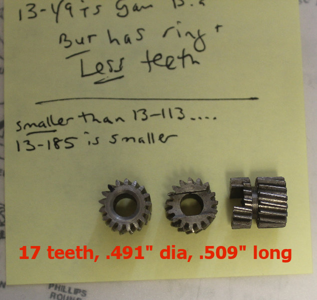

Hi!
I'm stumped. I have not notes anywhere on this one.
A bunch of these mixed in with our inventory of 13-113H.
Not the same diameter...13-113H is .460" and these are .491" and they don't have a ring.
Nearest match I found was 13-49...but this has 17 teeth and 49 has less.
Any ideas? I appreciate any direction on identifying these.
~Mo

I'm not sure what it's for, I do know I have a few. Not sure if this helps, but I did find one of the samepinion in a separate bag with a 5-66 main gear.
Is the 5-130 close to the 5-66?
Not much success here either, Mo --
Was hoping to find a match in the Penn envelopes -- did not -- so went to the loose guys in the divider boxes.
According to your measurements and 17 teeth -- found 14 that matched -- 3 of these appear to be brass, not steel -- possibly indicating an older reel in the LB line.
I do not have a 130 to compare -- however, since I have 14 of these -- I do not think it would be the more rare 130 -- but I am usually wrong when it comes to gears -- unless I can match it to a reel on my bench.
One of the pinions has Yamaha Blue Marine grease still on it -- and I overhauled about 30 of those LBs in the last 3 years.  If, after testing a reel put together from assorted parts -- and I detecting any gear noise or an imperfect meshing -- I would just toss the gear back into the bins -- and try another.  Sometimes with old reels -- a worn gear works better than a new one -- depending on how it interacts with the main.
If I have 14, and Sal has more -- it is likely kind of common.
Fred, I also have brass pinions in the same dimensions, but those have finer teeth.

The 13-130 has 13 teeth and looks be the same size as a 13-113H.
130 on the left, 113H on the right
A 13-85 seaboy pinion looks to be the right diameter with 17 teeth.
mizmo67
I don't have any samples of the 130 sailfisher main/pinion gears.
ID is .213" on these. I have about 20+ of them so no rare either.
13-85 looks the closeset, it's brass and has the ring but it's not the gear either..13-85 is .471" dia :(
Paired with a 5-66??? Sal sent me back to the bins and.
13-60 is stainless and matches perfectly. Mystery solved!

A gear with the reinforcing ring is called a hobbed gear.
mizmo67
Quote from: Keta on May 13, 2017, 04:40:19 PM
Always learning!
Since the 13-60 gears come up as slightly larger diameter than the 13-85 gear, does that mean they won't fit in the gears that currently use the 85? It's not a giant difference. .471 br to .491 ss
I don't even have these 13-60's online!
~Mo
Maureen Albertson :)

Quote from: mizmo67 on May 13, 2017, 04:36:19 PM
Great, Mo --
We all learn now...
A few years ago I restored around 30 of the Long Beaches from 60 to 68s.
The smaller ones like the 60 & 65, along with 78, 85, 285, 309, and maybe a few others -- all use the 13-60.
These were restored completely with the intention of them being snapped up like waffles at the coffee shop when I tried to sell them at shows -- might have sold one out of 30...
So that is where a lot of my 13-60s came from, I guess.
Mystery solved -- thanks to your question.
