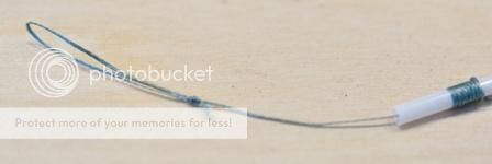

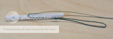

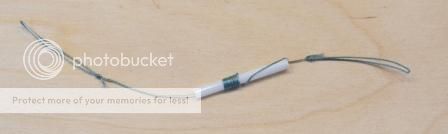

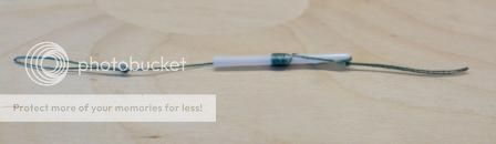

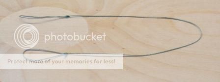

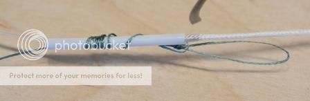

I make nail knots “to go” that look like this: a straw with a nail knot around it.  The spectra used it 30# solid spectra, this time JB green.  I will purchase some 20# solid spectra soon from Charkbait for future rigging. As you can see there are loops tied at each end to use when tightening the nail knot.

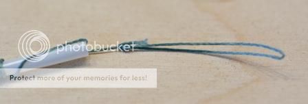

Here is each end in close up; the two sides are different.  This end has a loop of spectra going over the straw.  The nail knot slides off of this end of the straw.
This is the other end with a single strand of spectra coming out of the straw.  Do not slide off the nail knot in this direction.

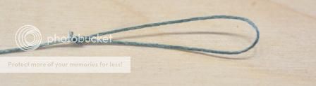

I make different types of “pullers” to help me tighten the knots, here are the ones I make and use for nub nail knots – they are smooth and short.

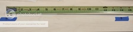

Start by measuring out 15” of 20#-30# solid spectra.

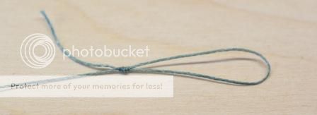

Tie a TIGHT double overhand knot using as little spectra as possible, but make the opening to fit the pullers.
Trim the knot close
Do this on both ends to yield something like this.

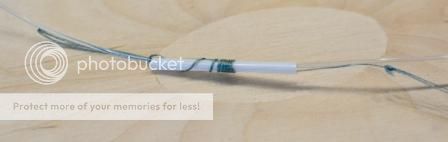

Bend the spectra leaving about an inch of overlap and hold it to the piece of stirring straw.  Be sure to use straws with a single opening (not double).
Wrap the longer end away from the center tightly toward the end of the straw and the loop. I make 9 wraps.  Mine loosened as I made the photo; normally quick work and holding it in your hand keeps it tightly coiled.
Insert the other loop into the end of the straw while keeping the coils tight.
Pull gently to tighten the entire knot and center the coils on the straw.  I store 30-40 of these on fishing trips in case I need to change out a top shot.  I need at least three per connection.

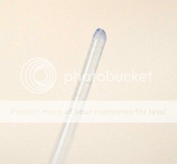

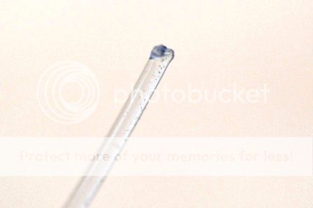

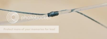

I prepare the mono by sanding the end so it easily sides inside the hollow spectra.  You could use a threading needle instead of sanding.  The photos show the end of the mono before and after sanding.
Insert the sanded end into the nub nail straw, be careful not to catch the spectra.  Slide it forward to your desired length you want inside the hollow spectra.

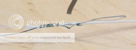

Slide one of the two nail knot straws toward the nub.  Again, be careful to keep the coils tight.  Bring is just past the nub.  The goal is to slide the nail knot off of the straw just next to the nub.  In the photo below mine will slide off to the right.  The nub has a black indicator above it in the photo.
Here it is with the straw removed and very close to the nub, but not close enough.  The black indicator shows the location of the nub (inside the hollow spectra).

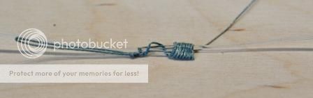

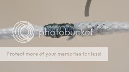

Slide toward the nub and tighten using pullers to yield contact.

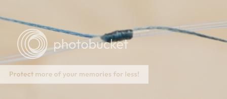

Bounce tighten with increasing outward pressure until the spectra breaks.  Trim the ends.  Notice that you now have a nail knot right next to a nub – a nub nail knot!

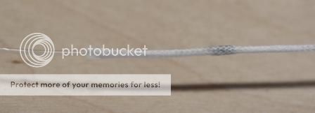

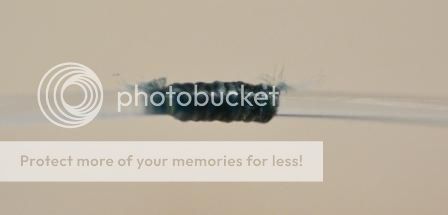

I go further and add a second nail knot close to the frayed end of the hollow spectra.  Slide the second prepared nail knot straw toward your nub nail so that when you remove it from the straw it will be STILL ON THE HOLLOW SPECTRA.  If you end up on the mono you will most likely not get it back past the frayed end.  The photo below shows a nail knot off of the straw in the right place.  Practice and slow down for this step.

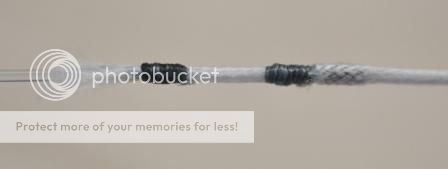

Bounce tighten and trim the second nail knot.  Notice the nub on the right followed by a nail knot close to it and one near the frayed end.  The second nail knot appears black and not green (a good sign of a very tight knot).

Here is a completed nub nail knot connection indicating how much mono is inside the hollow spectra – 14”.

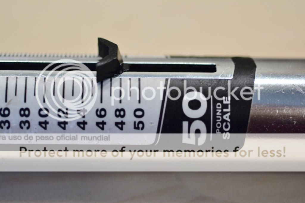

I tested the connection using a spring scale; mine goes to 50#.  The connection held to 48# without a whimper or even a bit of slippage.  That will work here in the shop or on a fish on your next trip.  Almost no fisherman other than a super skilled, strong deckhand uses that much drag pressure on 80# test mono.
