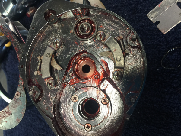

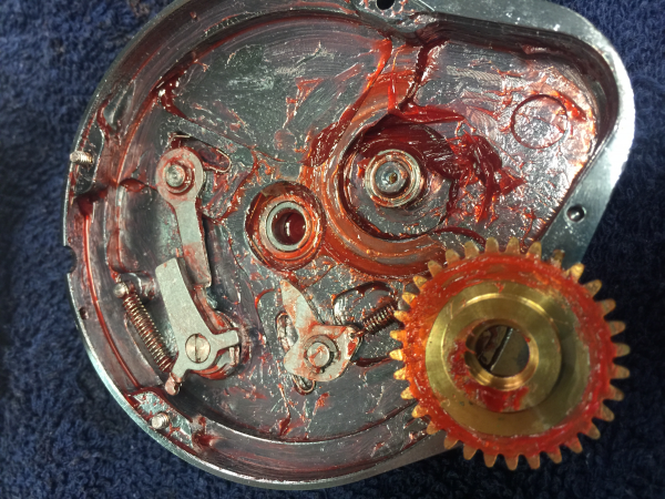

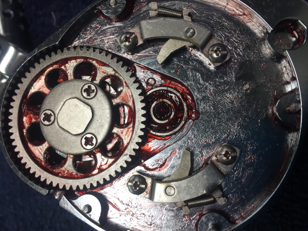

I also like to have dogs in my reels for anything over 30 lb test even if their are there as just backups to the ARB. Heck, my 30 lb go to reel has double dogs to backup its ARB. Will the dogs ever be needed to fish 10 lbs of drag? I don't know but I do like the piece of mind of having them in there.
