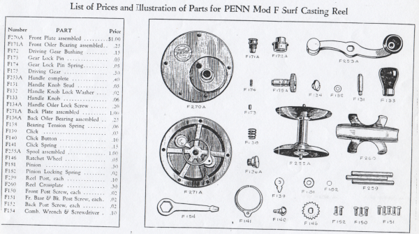

Great beginning for a new Penn collection. The 1933 Sea Hawk is the copy of the Model F, the first Penn prototype in my opinion.
The plating came off easy because it is not chrome. The 1933 Sea Ford was nickel plated only.
Here is your Model F parts breakdown. Exactly like your Sea Hawk!

Awesome! That is great to have along with the reel. Thank you Mr. "Penn Chronology". So what is that metal, it looks like copper under the silver?
