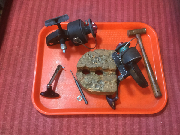

I have two DAM Quick spinning reels, a 331N and a 220N. I can't remove the handle from either. I'm afraid to apply too much pressure because I don't want to damage anything. Do I just rotate it backwards? Thanks!

Hi Bill —

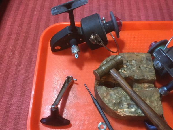

Just punch out the roll pins with a 3/32" punch, block of wood with a hole, and a small hammer.
They key to DAM Quick Servicing and restoration — is to first get the handle off —everything else follows that.
akfish
Thanks! That did the trick, although I can't imagine why DAM designed the handles that way...
