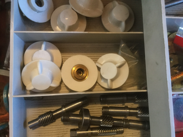

Hi Jason —
Since Scott's is out of these, I can send you a new white drag knob.
710 & 712 use the same knob.
Don't have the emblem though, just 713, 700, 704, 710.
If you can't find an emblem, just get a brass disc from a hobby store or hardware store — then take it to a trophy shop to have his name engraved on it along with the 712 label.  Would make a nice present all polished up with his name on it.
N/C if you could use the knob.
PM me your full mailing info.
It will go out Monday.

Tom, the knob above is shared by other reels as well and not just the Z series.
