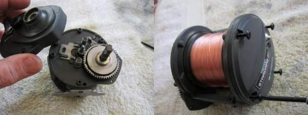

Unscrew all four frame screws on the handle side, then locate and undo the two little screws that back onto the main gear housing.
Off comes the right side plate... The bearing is likely to have come away with the side plate, so push it through and set aside for cleaning, lube etc.
Undo the four left side plate screws and remove the plate. This will allow the removal of the spool assembly.

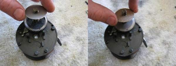

With the aid of Cal's drag grease, reassemble the drag plates as per the following order...
Anti-reverse ratchet (and pawl/spring assembly), followed by the drive shaft washer, ie the smallest fibre drag washer.
Main gear next, then the eared fibre washer, eared washer 'B'.
Keyed metal washer ('C') next, then the black drag washer ('I').
The eared metal washer ('E') is next - be sure to face the ears downwards into the drag stack.
The last fibre washer ('D') is on next.
Slide the last keyed washer ('F') into place and the drag washer assembly is complete.

replace the right side plate and be sure to align the eccentric lever and the yoke plate before fastening down.
Replace all four side plate screws and fasten down. I also added a bead of grease around the top of the ball bearing, which isn't shown here.
Replace the two smaller side plate screws to fasten down the main gear housing.

those drag washers dont look right,are they carbon fibre?
redsetta
No, they're standard - the white ones are a cloth fibre/weave (Shimano call them 'titanium').
I'm unsure what the black one is.
The owner is fishing the reel this week, but the Carbontex won't arrive (in NZ) for a couple of weeks ...
By the way, I just realised that the 3GT is basically identical to the TLD 15/30, which Alan's already covered.
Apologies for the duplication.
