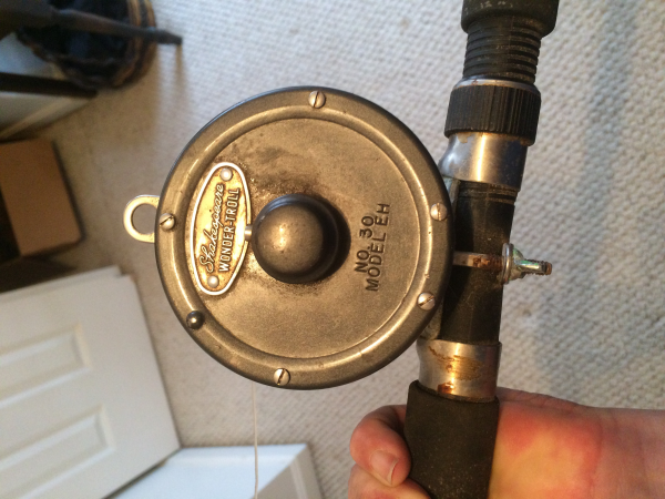

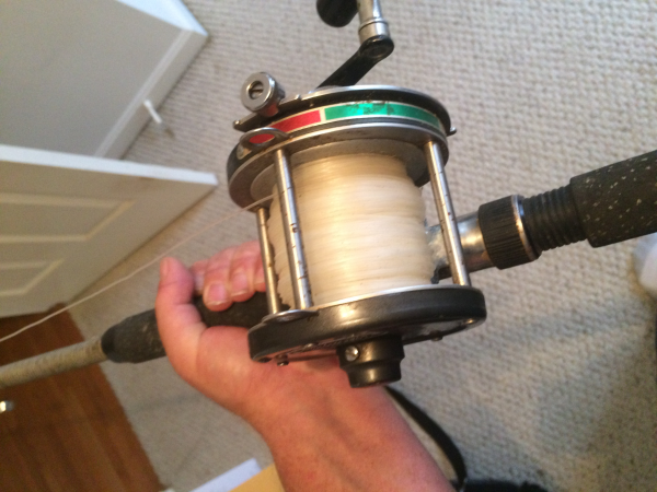

This is reportedly a Harnell that was custom wrapped with Fuji BNLG's and seat, cork taped grip.  Not exactly sure, however it is a construction as you state. It was traded to me fifteen years ago by a kingfishing buddy, who has probably passed on now, in exchange for a Thorhammer-matched rewrap of his gold Fenwick anchor and fighting rods. Shown with it's motor.
I have some more of these rods somewhere.
