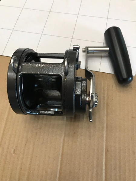

   This reel is made from donated parts and a hodgepodge of sorts.  The painting seems to blend it together as the plates,and frame were all different colors.

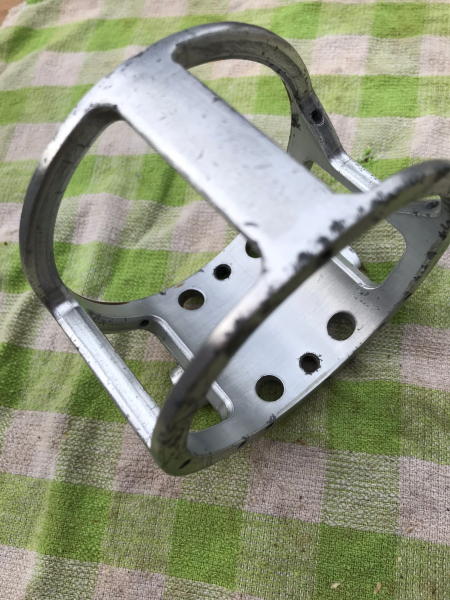

The left side plate is an Accurate, right side plate was a gift from Sal and is J Variance,  the frame is an Accurate as is the spool.

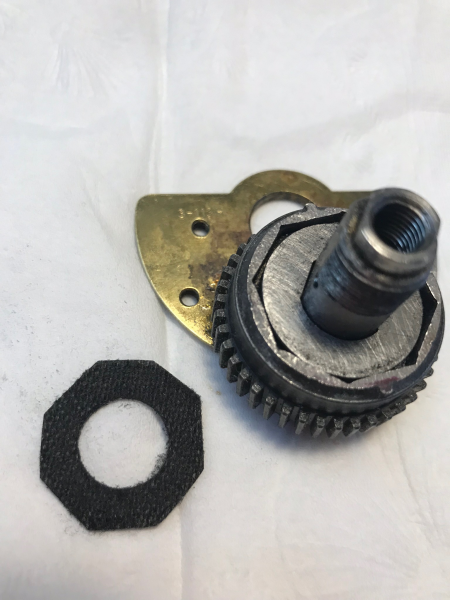

The reel is meant to be fished,  it's not a mantle piece for sure.  The frame seemed to have good screw threads butt was quite corroded and pitting is evident.  As the drag system is important to me a steel gear was used. Lee made the hex insert and it was a gifted from Sal.  As were some stainless shift parts.

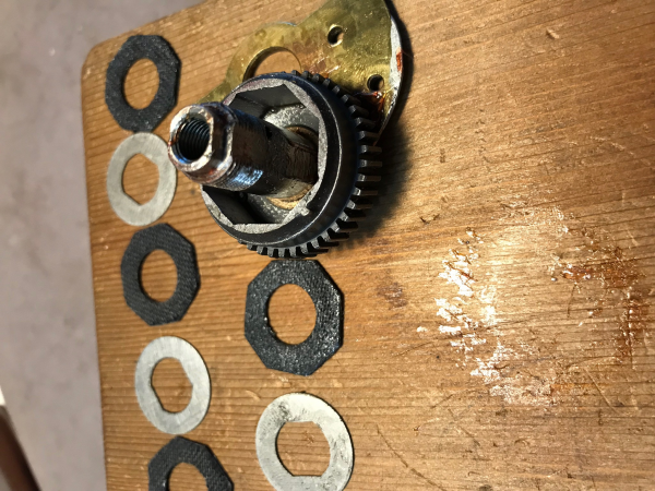

Some more parts were needed so it more delays.  So I made the drag package from parts left over that could be modified.  The paint isn't great, butt it helps.
These inserts are great as I've used them before.  The .025" titanium washers were trimmed in diameter as they were from an early earned drag.  New carbon fiber washers were made to fit the insert.   Soon testing will be shown as the weather is warming above freezing outside.

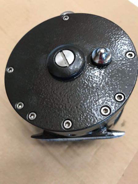

   The end plate for the double dog had been modified so it had to be redone.  Double sst dogs make these plates very strong.   I am testing acetal washers above the thicker top drag washers in place of the cone washer.   So far so good.

My primary goal was to use the parts that were given to me, add some things I had already and use the things I have learned from this forum for building another great halibut reel.   More pictures will follow.

As the insert was taller than the steel gear a sixth cf washer could be used.  This seems good.

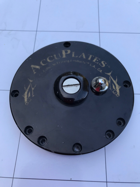

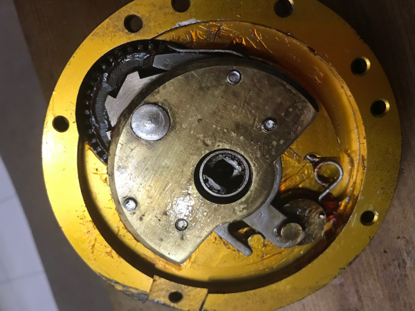

It seemed when Sal gave me the gold colored right side plate that added fuel ⛽️ to the fire.  A useable left plate was found.   This was good.   The pic before painting below.

The grey auto primer was used on all three pieces, then some Rustolium hammered paint sort of blended the stuff together.  I've used this before for stuff with a poor finish and it's a compromise that I can accept.
