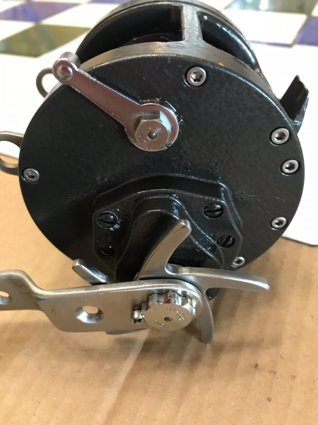

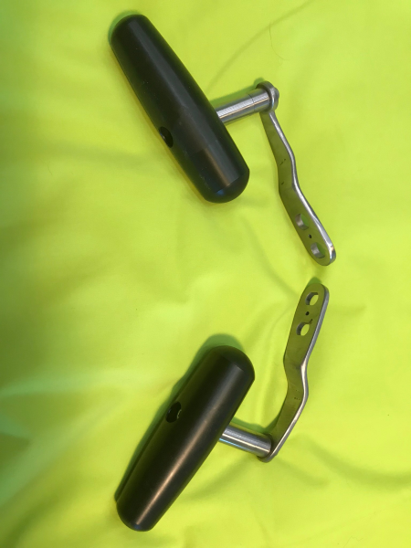

The crank side assembly missing in the earlier section.  This will be bulletproof.  For this size reel it will get er done. ;)

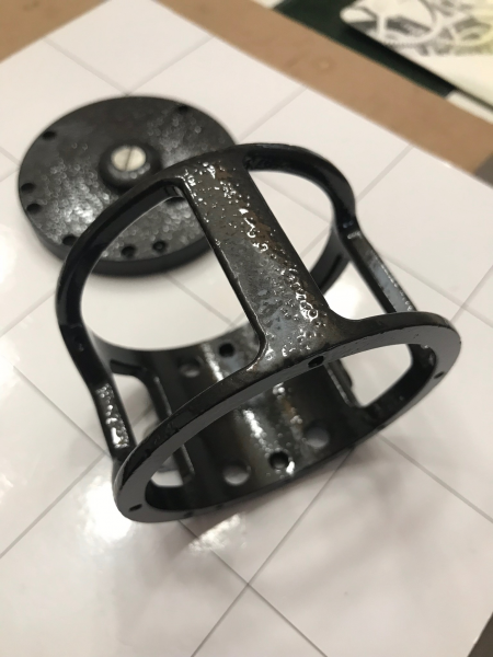

The miss matched parts painted. We got a skiff more snow ❄️ last night.  So I,m indoor s till after breakfast 🍳.
Thanks for watching this post.  The mate to these crank arms originated from AlanTani and they were lengthened and offset by me for more comfort and power .  These were custom made for a friend .

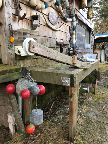

As yesterday was spool the line on day,  the ugly reel was filled with tightly wound Jerry Brown 80# solid braid.  Hopefully drag testing will pass muster.   So stop by soon. 🙋‍♂️

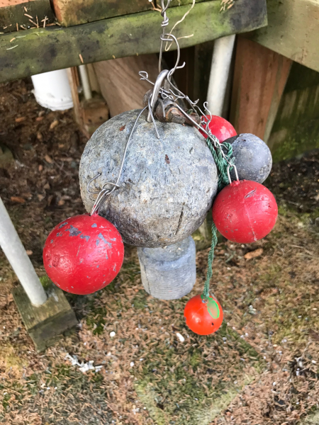

Here is a view of some lead hanging.  The big ball is 25#,  that seems like a good place to start, tightening the Star, another 10# was added.  Slightly better I thought.  So then it was tightened pretty good,  slowly adding weight to more than 46#!   That's plenty I,m 🤔 thinking.
  I,m not wanting to go more, nor break anything as it's more than fifty percent of my line strength.  I,m not capable of holding the rod at any where near that anyway.
  The reel is ready for battle.  Now it's up to me.   I,m happy with making something out of nothing.   Thanks 🙏..
Some weight shown.  The drag was then run out in the yard be walking.  It seems smooth until the spectra stretches and cuts in some.  Butt that's ok,  let's go get some fish 🐠 pictures now.
looks to me like you made a downrigger :)

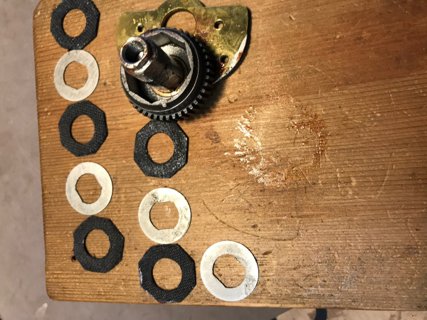

gary, all the process and the salvaging parts into a powerhouse reel is awesome, but tell me how do you managed to get 46# of drag from that reel?
the drag upgrade I see there is Keta octagon insert, I also have one but my drag readings topped it at 28# which is really good in my books, yours ins almos double of that drag.
Im also using delring under main gear and top on the drag stack.
Thanks for the great question.  The insert is taller than the gear. By using keyed .025 thick custom titanium washers and .050" octagonal carbon fiber washers I was able to make the drag sandwich. There are 6 cf washers.  This picture shows 5 but found out there was room for on more in the insert then a fatty keyed washer on it.   Delrin washer and then the steel cone washer.   It fits in the aluminum plate no other mods.

 Mr. s. Fish.   I licked your question enough to share more detail.   I made a hex gear that's as good in my opinion ,  butt it was not worth the time and effort.  Butt it produced the same numbers.   Butt,  here is different s   The taller insert will hold an additional cf washer.   The hex gear drag compared has a larger diameter washered system.   By using thinner yet more washers you have added more drag surface area. ??🤦‍♀️
   If I can recollect mr Adam has said his 4/0 inserts will provide 40 plus # drag.  I have some and like them.   Drop in ngo.  👍
