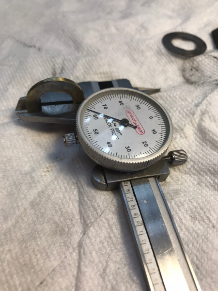

Gary, is that hex insert made out of a wrench socket?
The cf washers were hexagonal and easier than the eared ones that some of us used to use in yesterday year.
Alex,  yes, it's shown below.  Certainly strong.  It's a lot of work.  Butt,  thanks to the folks that went here before me,  you can order the equivalent on line as this stuff becomes available.

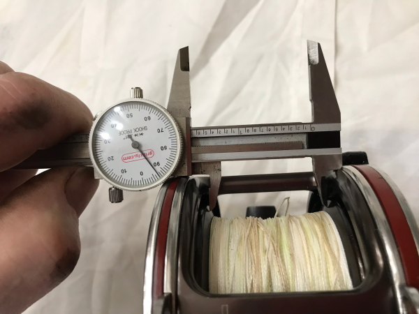

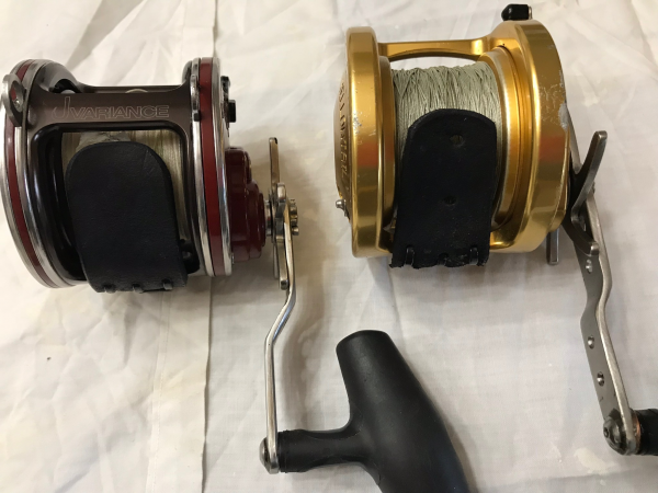

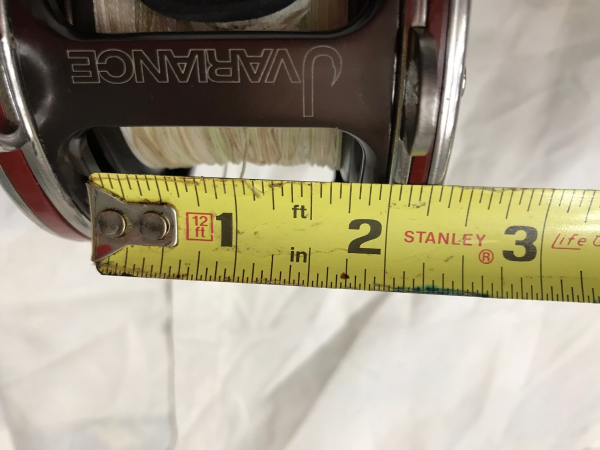

  After fishing these reels a little they're similar to the penn 113h YTS versions. Shown below is a j variance frame/spool that's a very solid tank.   The spool width is 1.70 inches and weighs 33.4 ounces.
This frame is in between the Accurate and the tiberon frame for weight and material removal.  The color is not much.   Butt?🤦‍♀️

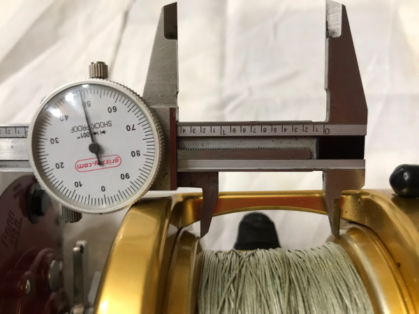

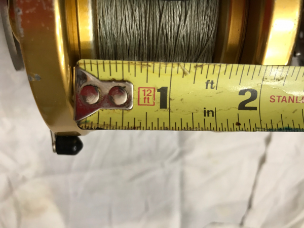

The 454 pg is a little narrower in the spool and frame and has slightly less line capacity.  It's spool width is 1.45 inches and weighs 32.7 ounces.   The pg 454 is .35 inch less in width and the diameter appears to be the same.   Just saying.
Other wise these are similar reels,  one you have to make from after market parts and the other can be bought used as is and modified.
   The pg 454 comes with and without the clicker option.  These are great little reels in my opinion.💁‍♂️
