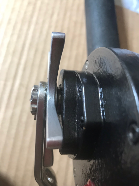

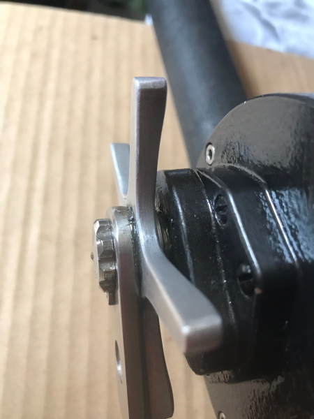

One side has to be flush to fit with no extra unneeded room to fit against the crank arm.  The other side the space tube can fit in the extra clearance provided.  I wish the gear sleeve was 3/16"longer for this type of application.
This is not perfect and is a learning process to later improvement.  Butt it will be tested first on my ugly duckling 🐥 tank.
I wish I had the means to do the tapping of the 114h size/gauge threads.  Butt aluminum is easily worked by hand compared to stainless or titanium so maybe I will have to try to be happy with what I can do.

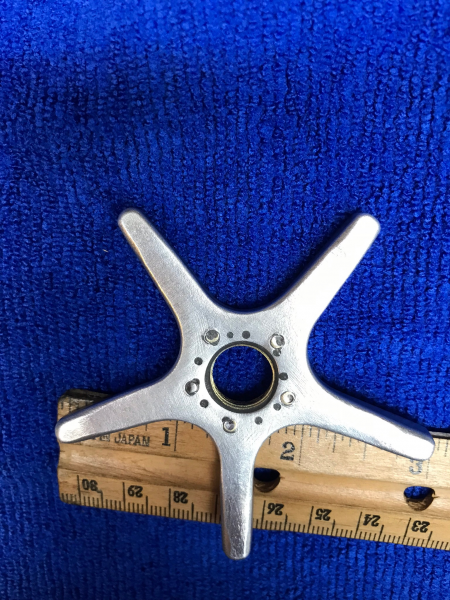

   Brass 🌟 stars seem to have no thread failure issues I'm aware of.  I,m not done yet.
More on this soon.   Thanks for watching.   Lets go fishing 🎣

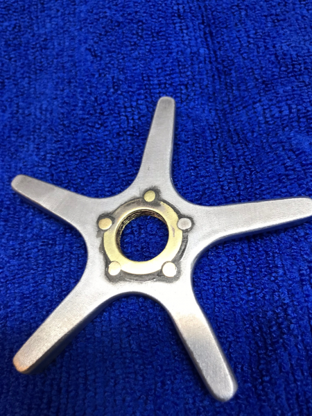

This last picture is the best improvement of the factory star I've seen and used.  It's just perfect 👌 yet unobtainable.  Machine costs seem too high to make it affordable or profitable.   Hey china 🇨🇳 here's a job to keep you busy?🌍🙈🤷‍♂️🤔
