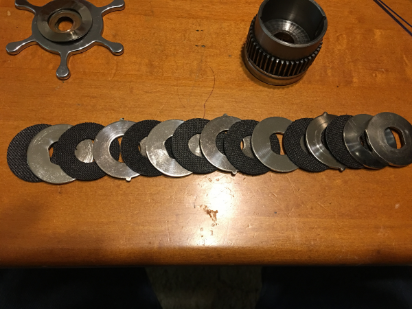

Welcome Rosgood14! Would it be possible to post a picture of your drag stack with all the washers spread out in the order that you have them?

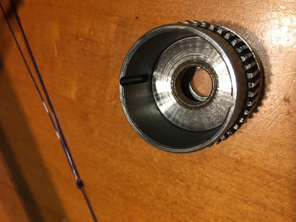

take a look at the slot that is cut in the side of the main gear.  note how it is only cut part way down.  with the old thick asbestos drag washers, it didn't matter, but with the newer thin carbon fiber drags, the "slotted" metal washer can bottom out against the base of that "slot" and behave like it was the bottom of the main gear.  this effectively takes the drag washers underneath all out of play.  check your main gear.  you may need a a new more modern gear that was designed for the ht-100 drag stack.  and remember, you always replace the main and pinion gears together as a set, never just one or the other.
I don't think that cut is an issue with a 16/0.
Your stack has to be out of order or something is missing.
I do these more often than most.
This is what your stack should look like.
There is only one extra washer on top.
It is a Belleville.

This is how they were in from left to right. The only thing I pulled out of this pic is the extra (old) asbestos washer I put in at the top when I was trouble shooting.

Quote from: alantani on May 28, 2018, 02:36:54 AM
This is my main gear and the slot looks deeper than the one you posted so I think it's not my problem. I also posted a pic of how all the drag washers were put in.

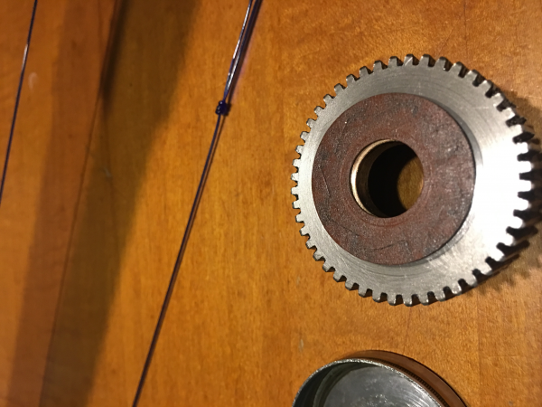

what do you have between the base of the gear sleeve and the gear itself?  your drag washers are in the proper order and the slots for the slotted metal washers are cut all the down to the bottom.  those are the first two most common causes.  you're not going metal to metal between the base of the gear sleeve and the main gear, are you?

It does have a washer under the main gear. It's not a metal one and I'm not sure what it is made of but it's there. Also the kid wasn't seven he was 75 pounds. How abouts would you like me to test the drag. I believe I have a weight scale hat goes up to 50 or 80lbs
Rosgood14
Should there be grease on the bottom of the main gear where that washer is. I cleaned it all off for the pic but figured I would ask to make sure.

I would use penn blue on all other parts, including under the main gear.
