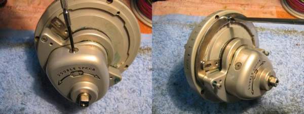

This is a Duel 6/0 two-speed. It's made in Italy and is rated to hold 800 yards of 50lb.
As far as I'm aware, the 6/0 generates nearly 20lbs of drag at the strike setting and nearly 33lbs at full.
I've heard of settings basically twice that, ie 32lbs at strike and more than 65lbs at full, with the addition of a few more drag springs, but have never tested this myself.
Certainly, the frame and engineering seem well able for this kind of capacity - it's beautifully made and built like the proverbial brick 'outhouse'.
Righto, let's kick it off...
First up, off with the gearbox assembly screws.
This won't release the gearbox as it's also fastened from the inside.
