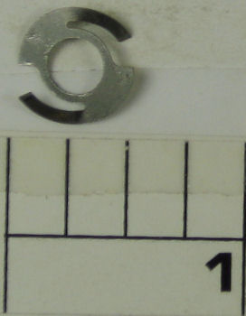

There is a little spring inside the cap (26D), overtime the ears compress and will result in less tension being applied.  To fix this just bend the ears out slightly more to give for more resistance.  Also the O-ring (120) helps the cap from backing out but like most rubber parts needs to be replaced occasionally.
