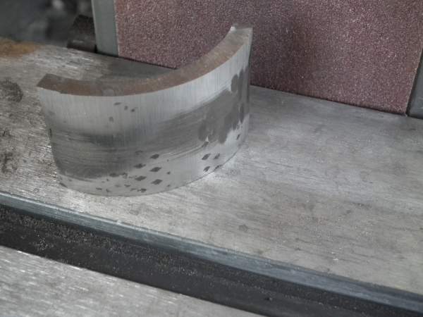

I've made more progress with the frame parts and cutting the spacer rings. There are two curved spacer bars and one flat bar that forms part of the new stand - the curved pieces were cut from a piece of 40 mm x 6 mm 316 SS plate that was bent around a 60 mm rod for frame parts when I made the 2/0 "bait special" last year. First step was to cut a section long enough, clean it up and square one end on the belt sander;
Then cut two curved pieces from it and a piece of flat 6 mm to size
Sand the three pieces to 36 mm width on the belt sander,
