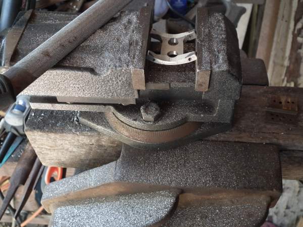

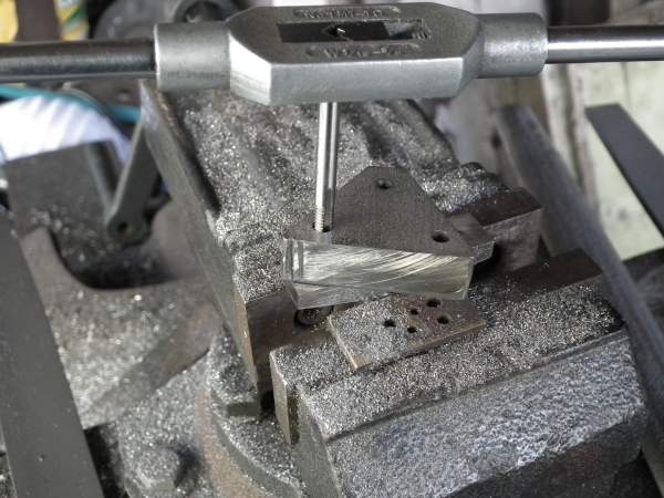

Another useful tip for keeping the tap vertical while hand tapping holes is to use a small block with a clearance hole drilled for the tap as a guide - Ed (eguinn) mentions it in Adam's thread on tapping and I've seen others mention it on this site. I've made one out of a scrap of 12 mm stainless with holes for 5-40, 6-40 and now 8-32 taps. These photos show using an 8-32 tap through a 4.3 mm hole.

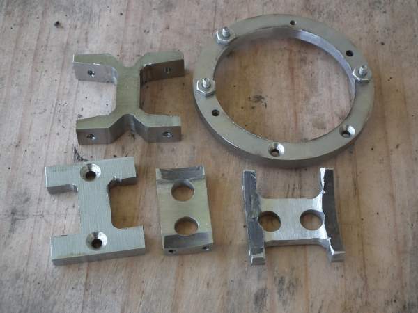

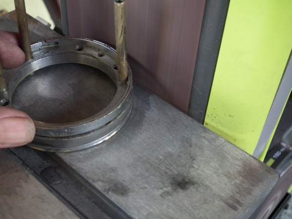

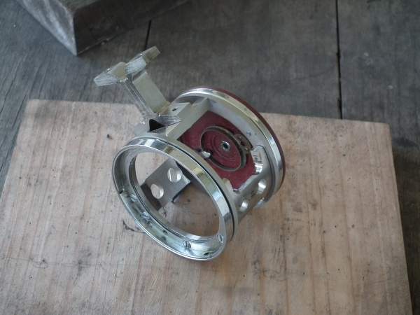

There is still a fair bit of filing and grinding to do but I thought I would update as I go. Using an old set of jigmaster rings as a guide screwed to the spacer rings, I filed the inside of spacer rings with a coarse half round file and sanded them with a 1/2 inch drum on the dremel.
I used a bench grinder and belt sander for the out side of the rings.

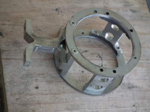

I've started cleaning up and shaping the frame components, grinding the backs of the spacer bars to reduce weight and shaping the leg.
I tried a quick test fit to see how things were sitting and give people an idea of how it will look,
Now it's back to the files,
This is crazy, Mike...what a masterpiece you're building!
Mike,
   This is getting good, real good!

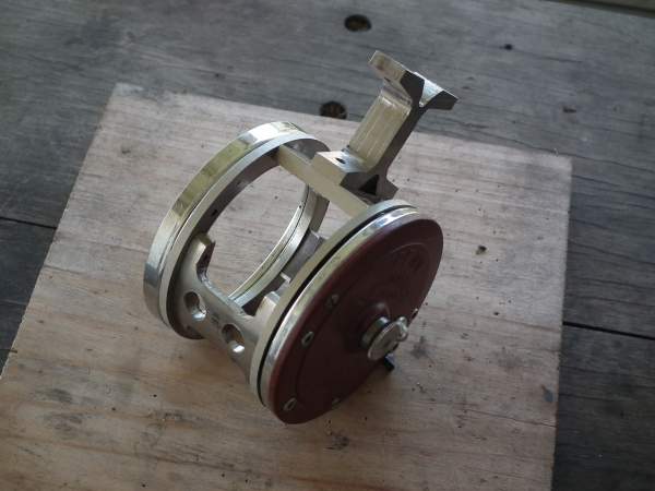

One question... what are the holes for in the reel seat? Is it for a clamp? Will you be making one of those too?
Awesome project bro,
Smols
Amazing! I am in awe that you are able to fabricate these parts with only basic tools. I have never fabricated any metal parts, but your posts are making me want to experiment with drilling, cutting and tapping.
How will you lay the line on the reel? The only underhead reels I have seen have a level wind mechanism.
Regards,
Smols
basto
Alveys and trout reels don't have level winds.
mhc
#29
Thanks again guys,
Dom - the two holes in the top of the leg are to screw a reel seat / foot onto. The leg is a bit narrow at 12 mm (~1/2") wide and most reel feet I've seen are around 16 - 20 mm, even round ABU feet are about 14.5 mm. I wasn't looking forward to filing the long groove on the underside of a reel foot so I asked Tom if he had any of the feet he uses on his frames. Not sure how to attach a rod clamp yet - I'll need to give it more thought.
Smols, the Jiggingmaster reels have a level-wind but the accurate mutants I've seen photos of don't have it but they do have very narrow spools. I thought of using the spool from the narrow 501 kits Randy P had made by Tiburon but unfortunately Tib didn't make any extra spools and only sold them as kits. I settled on a standard width 501 spool and was hoping to be able to guide the line with a finger under the rod but I think I might have made the leg a tad long for that. I'll see how this goes when I've finished it - maybe I'll need to put less line on to allow for poor line lay. Basto has a point about the Alvey reels, I used them many years ago and didn't have too many issues with line lay, it seemed to move from side to side a bit by slightly tilting the rod from side to side while retrieving - not sure if being under the rod helped with that or it was the bigger guides on the old side cast rods. ???
