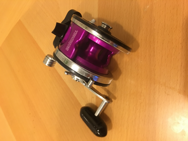

mikeysm
Just finished my reel except for the drag spacer. I will have to sand down so it will fit in Tom's plates.

mikeysm
This reel is so narrow I only have one rod it will fit. I may have to remove the rod clamp just to use it.
