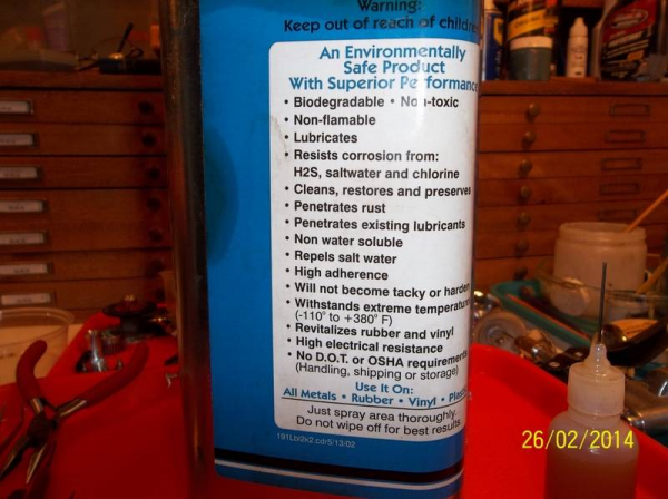

Synthetic oil, Wayne —
Oil---WRL 191S synthetic Non-Petroleum Industrial Lubricant.
According to the claims--it resists corrosion from H2O & saltwater, cleans, restores preserves, penetrates rust, penetrates existing lubricants, non water soluble, repels salt water, high adherence, will not become tacky or harden, withstands extreme temperatures (-110 to +380), revitalizes rubber, use on all metals, rubber, vinyl, plastic. I Get it from a railroad wholesale jobber--costs about $84.00 a gallon. Apply with a needle syringe or small brush.
I have used it for about 14 years now, and am on my 4th gallon in that time.  Will get another gallon before the end of the year.
It was only sold to in large quantities to large corporate users such as the railroads, military, crane companies, shipyards, and marine maintenance operations — until recently.  I knew a guy who helped me get some.
Clean and evacuate your bearings — then just drop them in this oil for 20 minutes while doing other reels — and they seem to bring back to smoothness all except for the roughest scored bearing assemblies.
I think I heard that the WRL stands for Wire Rope Lubricant — don't know about the 191, but the S stands for synthetic.
Very good stuff that is economical and extremely effective for salt or fresh water reel servicing and performance.
It also mixes well with Yamaha Marine to cut the thickness of the grease down.

That's it, Wayne —
You can see a few of the large companies that use it, including NASA, here:
Our Product
Known for its highly effective lubricating properties, ease of use, being remarkably clean and environmental friendly, Jaymors 191S has outstanding longevity and out performs almost any well known lubricant on the market today per laboratory testing results.

El Pescador
thanks Fred,
I'm going to pick up a refillable Pen  - a Gallon will last me 23 lifetimes ;D
Wayne
