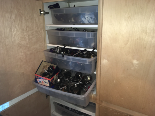

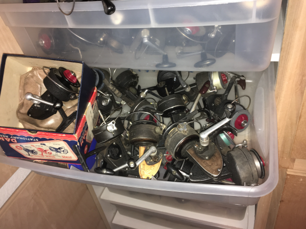

I have around 100 pounds of complete 280's & 285's waiting to be restored, plus about 40 pounds of NOS parts to help with these restorations.  And all of the above examples and variations are represented in the waiting bins.
These reels will handle every species ranging from trout, salmon, steelhead, bass, stripers, cats, and giant carp.
