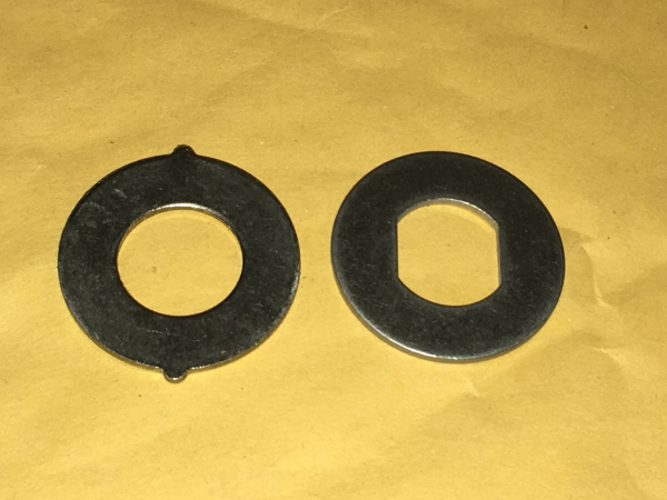

What's the difference between a "keyed" washer verses a "eared" washer????
 The hole in the keyed washer has a slot that fits the bridge post. The eared washer has 2 tits on the outside circumference that keep it from spinning in the gear.
pjstevko
Quote from: Frank on October 31, 2018, 09:20:58 PM
The hole in the keyed washer has a slot that fits the bridge post. The keyed washer has 2 tits on the outside circumference that keep it from spinning in the gear.
Did you mean eared?

I don't care about the wording I was just verifying that you meant the earned washer not keyed...
#14
Eared washer holds the gear — keyed washer holds the sleeve.
Eared on left — keyed on right.
Bryan's 5X5 thin stack should have (3) keyed and (2) eared.
If you still have an issue — Bryan will be along shortly.
Tolerances may need adjustment if a little out of free adjustment.
