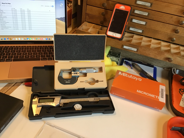

mikeysm
I have a set of 28 year old Tesa calipers. I also have a set of mitutoyo 0-6 inch micrometers. I have owned several cheap sets of calipers. That's just what they were cheap. Lasted less than a week.

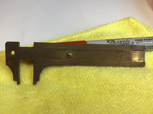

#12
These work for me.
And even an old brass one from West Germany works just fine.
The two fancier ones were gifted to me by members — and they work great.
The ones I have turn on when you move the dial and automatically turn off. It takes 2 batteries a year using them many times throughout the day.
Ill post a picture later.
