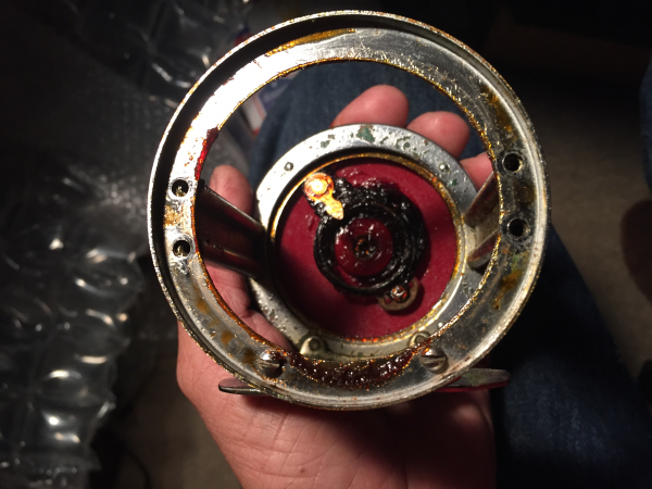

Hello Everyone,
So this will be my first post here. I have a question about the right side stand screws for a 500s I'm building. The schematic calls for 2- 32-15's, but they appear to be to long. They need to be very close to 1/8" long. I ground down some screws to fit, but I would rather have the right ones. Can anybody help me with the part number for the correct screw? Thanks to anyone who takes the time to help me and I hope I can help someone else in the future. :)Bart

Welcome Dynotec-Bart! Yeah. If they stick out like in your photo, they can make gettin a birds nest out that much more difficult, as they will catch onto the loops of line.
Dynotec
Here's some more info. on my problem. Joe, I tried those screws and there's an interference problem. The holes in the side plates(rings) on the 500s are not countersunk. The plate itself has a nice round hole that a pan head screw fits into. Thanks Bart

Thorhammer, thank you. My problem is on the right side though. And to check the bottom screws you would have to take your reel apart, I wouldn't ask you to do that. The two reel seat screws are inside the right side plate. On a right handed reel of course ;)
Either you have the inside plates switch or we are talking about opposite sides. If you follow the schismatics it shows the side those two screws are supposed to go on.

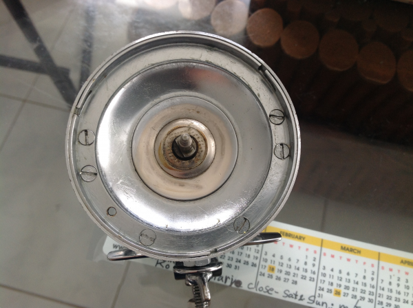

Here's the right side of a 500s. They're not counter sunk holes. Looks like the standard penn screw just really short threads
Picture is upside down.
mhc
#12
The 500S schematic shows the same inner stand screw 32-15 on both sides http://www.mysticparts.com/Assets/images/pennparts/schematics/500s.pdf
However the 500S I've got uses different screws on the handle side. Same short length, different heads  ??? The recess in the right side plate that the screw head fits into is not large enough for the pan head screws that are used on the left side (see below)
The two RHS screws that are on my reel look very much like the handle nut lock screw 110-60.
PS - Looks like Sheridan's are the same as mine
Dynotec
Mike, you hit the nail right on the head. Those are the correct screws that I need!
