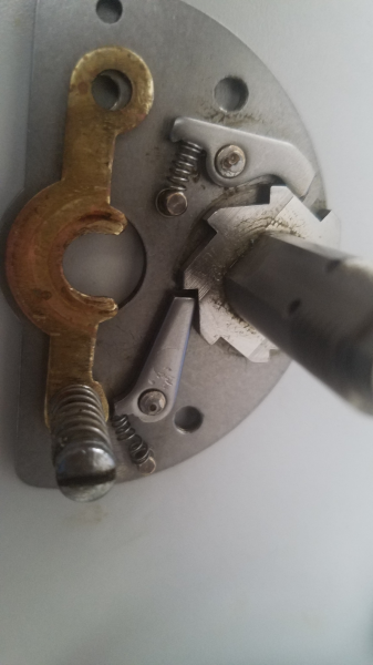

I travel on business and bought a Pro Challenger DD bridge for my sons 112H (3/0) a while ago but unable to install until today. It was his first build and has a SS (Tani) bridge sleeve, Bryan's drag stack & an Accurate frame from Randy Pauly and have all been great upgrades.
Today we went to install the bridge but were having issues with the the clutch engaging. After a few dis-assemblies and trying to troubleshot I noticed the longer of the two dogs was not operating. Long story short I noticed the dog is partially covering the upper bridge screw hole. This was forcing this dog to not engage on the gear. So at first evaluation I'm thinking "no big deal" I will Dremel down the dog for clearance. So I gain the clearance I need and took off about all the material I felt comfortable with just to maintain some integrity on the dog. I reassembled and the same thing- no engagement! That's when I realized that this hole is the upper bridge hole & has the clutch springs on the outside. I really don't want to take off any more dog material and will probably just run with a single dog which is a serious bummer.
So the big question is.....has anyone else noticed this issue? If you assembled it as is you are probably operating with only one functional dog.......

Honestly, the only reason I noticed this was because I was making this so the dogs would alternate and it wouldn't report when turning. This dog is practically invisible due to it location and would be very difficult to visually verify it's operation. It would (audibly) stop when fully tightened and operate when the bridge screws were loose and gained some clearance.
Darin Crofton
   It looks to me like what is contacting the dog isn't the spring but the yoke. The jack sits on the bridge, the yoke sits on the jack, and the spring on the yoke. This pic of some old pieces shows how they stack up under the bridge. Just off the top of my head...a flat spring would ease your pain. Cut a slot through the spring post (if it's big enough) and bend the flat spring into shape.

What you need to do is to remove that dog and use the stock dog on that side. Or send it back and let Alan deal with it.
I have 2, I put one in the narrow kit from Randy and saving one for a stock width when I get some plates. It does have alot of play in the handle. I'll have to open in up and check it out. If it's hitting the yoke would it make sense to take some meat off the yoke where it hits? the yoke is stainless so it should be plenty strong.
I'm only guessing but the picture I see I would reverse the dogs/switch them to see if that doesn't work.

So, i ended up trimming the dog a bit more and slightly modified the yoke as well. The dog I machined some slots for the spring to grab onto and it does not slip off. I mocked this up with the brass yoke & jack and as you can see it has clearance and both dogs function as designed. I did ensure I had enough yoke for the spring to have plenty of foundation for any unexpected movement. I will test this on some trigger's if the marine forecast ever subsides here and report back but i'm really confident I won't encounter any issues.
