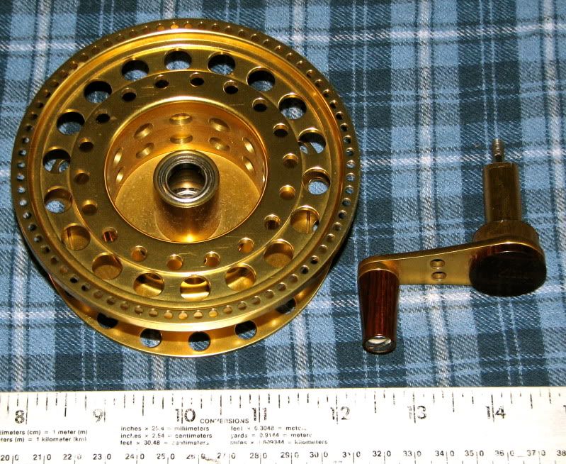

It could be that the spool bearing is shot.
It may be a similar problem to a dud right-side bearing on a lever drag.

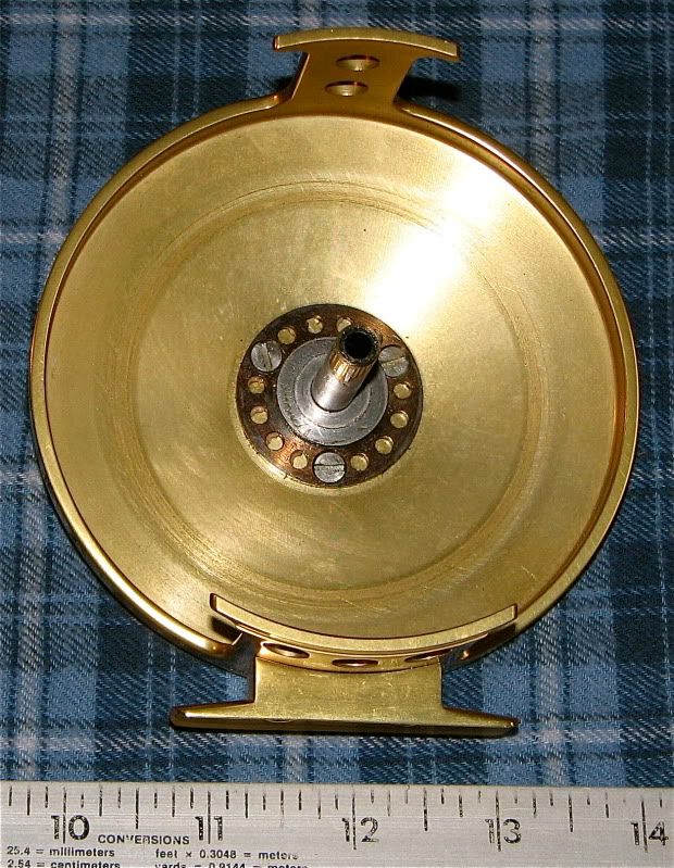

Here are some pics I've located:
The spool bearing sits against the handle sleeve and (I believe) is binding the spool when under load.
Try replacing the bearing and let us know how you go.
Hope that's of some assistance.
Good luck, Justin

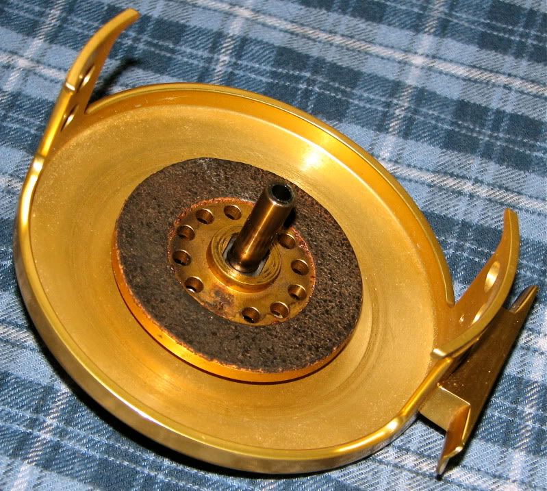

is that a cork washer in there

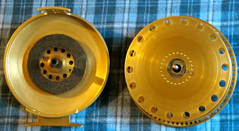

Having had another look at this, I think I was a bit off the mark about bearing load...
(That said, I've seen some reviews that suggest these bearings get bound up with grit etc fairly easily.)
The drag washer should turn with the handle. The spool floats between the two, held fast by the drag preset.

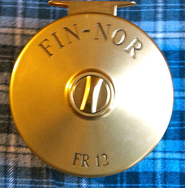

There's a direct drive and anti-reverse range of FRs - the above pics being of the anti-reverse, which I assume is built into the handle.
Here's both ranges - DD above and anti-reverse below:
If the spool/handle is binding, the drag washer may have been reversed, the spool bearings may be had it, or the anti-reverse mechanism may be failing.
Beyond that, I'm at a loss...  Wink
Hope the pictures are of some assistance nonetheless.
Good luck, Justin
yes it is.  the fly reel market is stuck in the 1960's.  cork is considered to be the best possible drag material in the world.  anyone up fro a challenge?  we could turn the fly reel industry on it's ears!

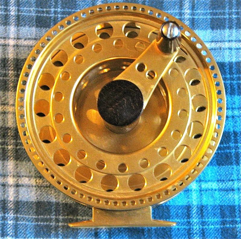

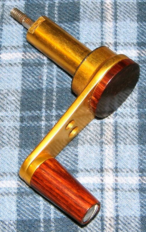

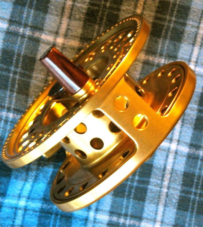

I realize this is an old post but the information may do someone some good, this is not an uncommon problem.  I should also qualify my answer a little bit.  All of those photographs that you see above are my reels; the anti-reverse FR-12 is mine as is the full set of FR (Fast Retrieve) reels shown in the second photo.
There is nothing wrong with your reel, the binding you are feeling comes from not having the handle properly aligned when putting the spool back on the reel.  It happens all the time and all of the reels, both the direct drive and the anti-reverse reels do it, even the extremely rare (13 produced) Willmington* reels do it.
If the poster still needs a copy of the blown-up parts diagram I think I can copy and convert one to a PDF file and post it somewhere it can be easily seen.  I'm not the most computer literate clown in this circus but I believe I can do that.  Oh, and I have the blow-ups for both the Florida and North Carolina reels though I have never bothered to compare the two to see if there are any differences.  I do know that there were several production runs when the reels were produced and that the spools for early reels will not interchange successfully with older reels.

Hi, Alan. The "Islander" reels made up here also use a cork drag washer, prepped with graphite dust, and neat's foot oil.  Folks have tried the carbon, and it fails for whatever reason.  I'll contact a world-famous repair outlet up here, that's put big lever drag Penn style washers in, only to have the sport who owns the reel, demand that the cork be put back.  I'll have an answer sometime after monday. Cheers, Ken.

« Reply #13 on: September 02, 2012, 03:15:32 PM »
Got my answer....fly reels usually have an aluminum spool. Carbontex's cloth is woven, and the "pips" in the weave tend to grind the aluminum away, causing the reel to chatter and stutter, as the carbon cloth loads up with aluminum frass. Cork does not grind away on the spool.
