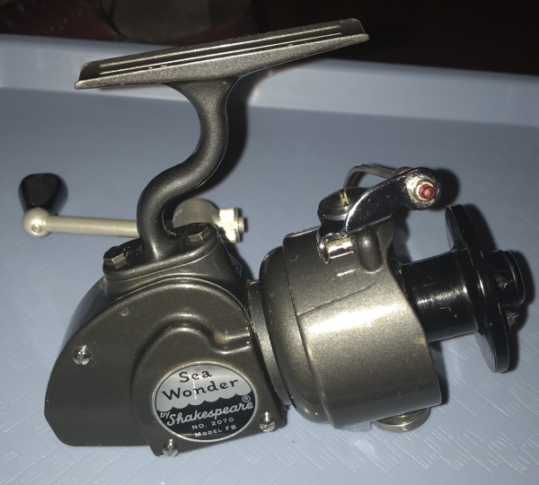

Hey guys
I'm tearing down a 2070 FB and ran into a couple of small parts that are a challenge for my giant fingers.

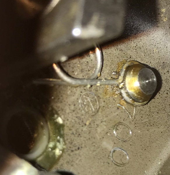

The spring on the throwout lever doesn't want to come off. It seems to fit it a groove on the bottom of the post and is flush with the inside of the casing. I don't want to damage it trying to remove it.
There is also a little tiny cotter pin(?) that holds on the non-reverse pawl that I am sure I can remove but I am not confident I could re-install without great difficulty. Any suggestions or encouragement would be appreciated.

   There is really no need to remove those parts if they are fully functional...like you said...you'd stand a chance of damaging something. Just wash them off with soap and a toothbrush...she'll be good as new. 8)

I'm new at this and trying to live up to Fred's high standards. I know he is correct in saying all parts need to be removed and cleaned and lubricated in order to do a proper service. My mindset is like his but my skills currently are not. I just might try to get the pawl removed because I think I can.

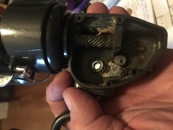

When I first received this reel the handle would not move in either direction. I wish I had taken a picture of the inside when I removed the side plate. The grease was like concrete.

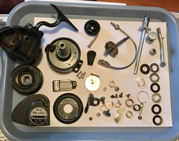

Here are all the parts cleaned and ready for assembly.

I need to get clear on which parts should be greased and which should be oiled for the best performance and longevity.
There seems to be differences of opinion.
I oiled the bearings first and then packed them with grease.
I know the drag washers get grease and the gears also.
Bail spring and parts ?
Bail trip lever?
Clicker and spring?
Pawl Assembly?
Anti reverse ?
Spool shaft?
Looking for some guidance please.
Thank You
-Steve

Spool shaft = oil
All other parts you mentioned = oil + grease mix
Also, I'd "paint" marine grease on all interior surfaces and into screw holes.
These are what I do, others may know better.

If the drag washers (friction) are leather (like the later Maroons), I believe oil is the preferred lube, perhaps neatsfoot oil.

Frank,
I think the drag washers are leather.
I'm new at this and they weren't a familiar looking material.
They were very flexible, probably leather if that's what is OEM for this reel.
I don't think it was serviced very often. The grease was petrified.
I coated them with Reel Defense brand grease. It's what I had and is fairly liquid for a grease. I'll probably use Penn Blue grease and Super Lube on the 2090 that's next up. Cal's drag grease is on the wish list
