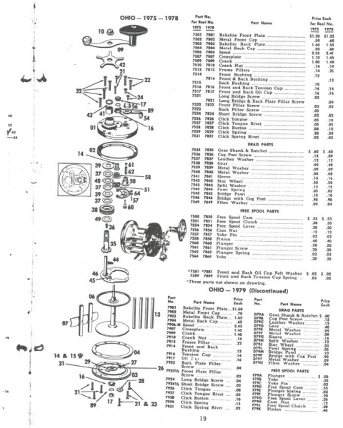

ORCA had it in the Pflueger 1960's parts and repair manual, here's the page for anyone else opening up a 1978

Does not show the AR set-up . ?
Cuttyhunker
The scan could be better, my bad, 45&46 are the dog and spring.  This was actually easier than a Penn to work on as the AR parts stayed nested in the headplate when I dropped the bridge. Everything is cleaned up and greased, now it's ready to go back on duty as a backup troller for the grouper this coming spring.  Will have to use it to land a few just for the bragging rights with ramp birds.
