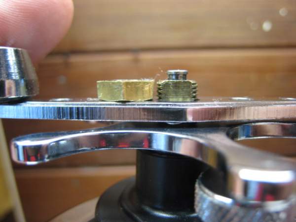

Saturday, while salmon fishing from a Half Moon Bay party boat, my daiwa sealine 27H was put to the test, and the new handle flunked!
This was my first reel breakdown and reassembly with all the Alan Tani approved jams & jellys, including a handle arm & grip upgrade.
The problem is the new handle arm is 4.02mm thick, and the stock daiwa handle arm is 2.99mm thick.
This caused the handle nut twice to loosen and made reeling in the 2 1/2 lbs. lead weight difficult.  The thicker handle arm did not give enough of the nut on the gear shaft threads.
What is the work around here??
- To  have a CNC shop mill out 1.03mm of the new handle arm stock the size of the handle nut?
- Get a new thinner handle?
love the longer new arm distance (from the center of the gear shaft to the center of the handle grip), do not want to go back to the stock handle!
What to do?  Need your help here!
Thank you!
Wayne
Here is the new Daiwa Power handle, notice how little of the gear shaft threads will be covered by the nut!  Looks like a problem.

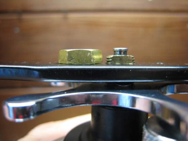

El Pescador
There is the Daiwa stock arm with handle nut.  Plenty of gear shaft threads for the handle nut.  Yes, I know the nut is upside down!
Wayne

Hi Wayne,
Why is the handle nut backing out?  Don't you have a locking cover on it?  You have more than 2 threads, and that should be sufficient to hold it down.  If you want to make that area thinner, I've got a grinder that you could use.  It's on only 1 mm.  Let me know.  Dominick's lovely wife invited us up for dinner in the distant near future, and I could bring out my grinder, we would remove 1 mm in a matter of seconds and you will be done.
Bryan

Yes, I did have the locking cover on the handle nut (which helped keep the handle from falling off), but with only 2 threads in the nut, it still loosened with use.
And I think removing 1mm will do the trick to have all the gear shaft threaded into the handle nut.

The work required to thin a spot under the nut can be done on any mill, if you have problems finding a shop that will do the work send it to me and I'll do it for you.
Wayne, I'm sure Lee would do a much nicer job than my grinder would.
