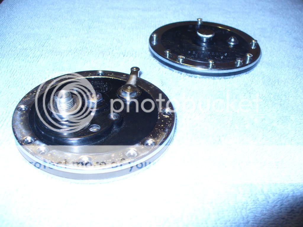

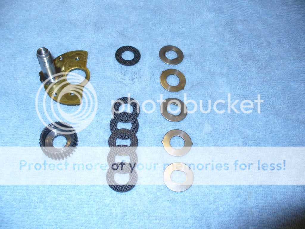

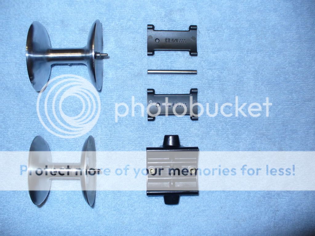

This Penn 113 was an inexpensive impulse bid on ebay and I didn't plan on fishing with it.  So, I was pleasantly surprised when I found out it has a steel main gear.  This made it a good candidate for a stainless steel gear sleeve and a 1+5 drag stack.  I think it can take a maximum drag of 12-15lb with 40 lb mono.  I like my reels narrow and knew a Longbeach 66 spool will fit, IF I can get a narrow frame.  I first thought about using a Tiburon YTS frame (a rather expensive route) but I got lucky and found a less expensive Newell RBYT foot and bars.

The original Senator 113 spool shown with the narrower Longbeach 66 spool and Newell parts.
The SS gear sleeve and steel main gear, along with the now standardized 1+5 drag washer stack.
On my Senators I always place the bellville washer on top of the spacer sleeve as shown.  It is easier to replace when it looses it's shape.

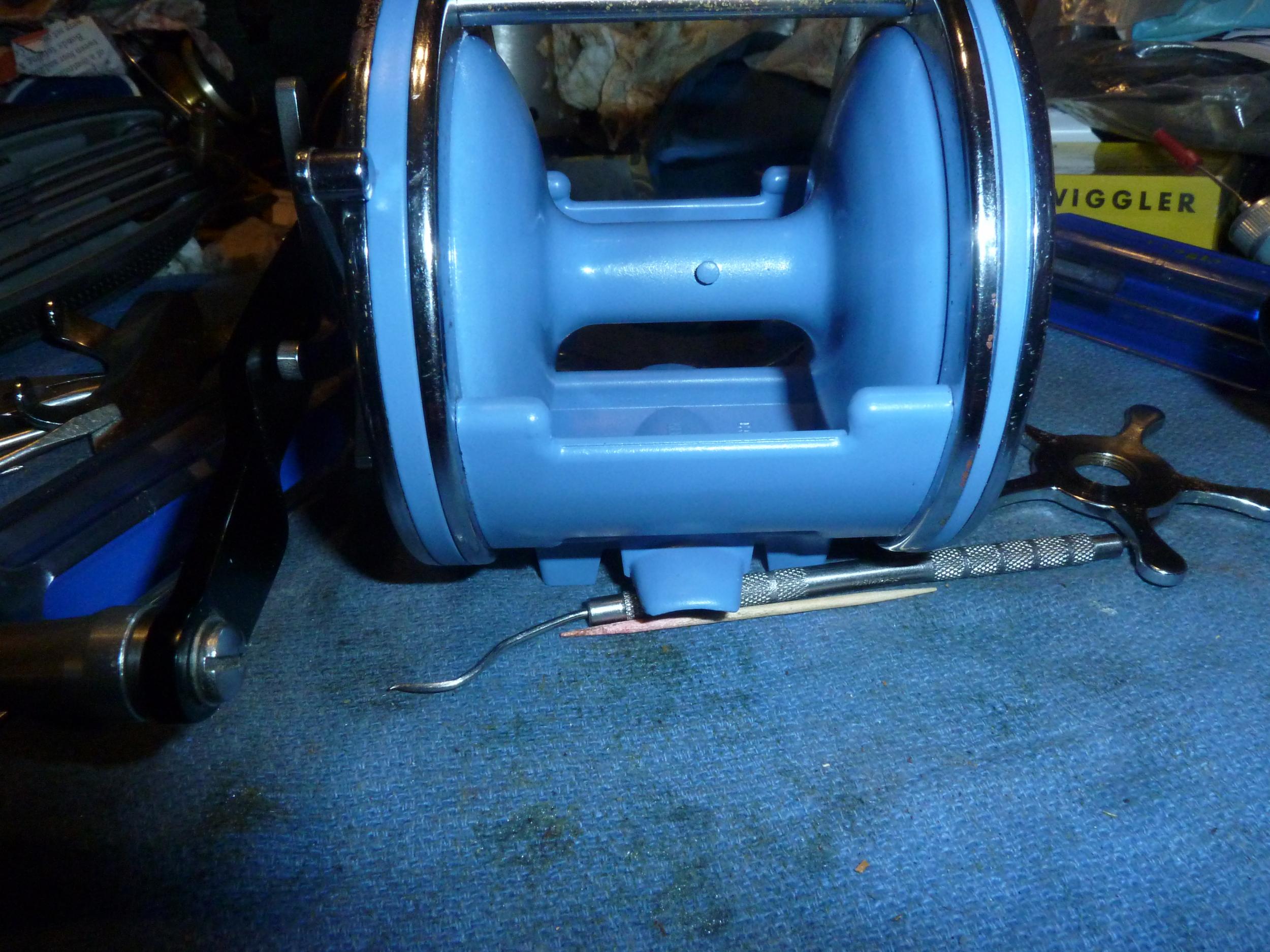

The assembled reel.  My only concern is the 3-piece spool distorting with the use of mono.  We'll see....

Ron, the 113 has a 6-screw foot, and the Longbeach a 4-screw foot.  That's why I went with the Newell reel foot.  I also assembled it to have something a little different.  It's only advantage (if any) over a 113H YTS is my reel has a little more torque when cranking.  Certainly a narrowed 113H will outshine it in every other way.
