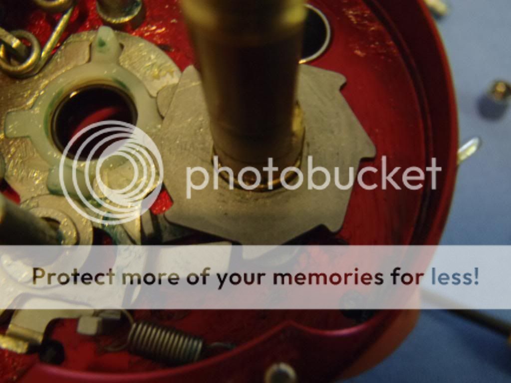

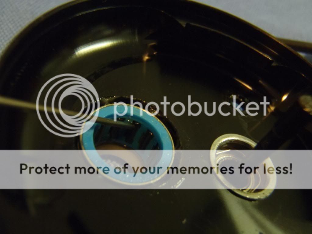

Preparing the right side plate
After cleaning and oiling with a corrosion resistant oil like CorrosionX, drop the small pinion support bearing into its housing.
The Antireverse roller bearings must not have grease or heavy oils on it or it will slip. Use CorrosionX to lightly oil it instead.

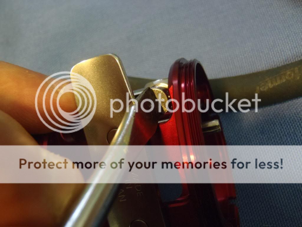

Carefully snap in the retaining circlip.
Carefully Does It
Take precaution that if this clip flies off, you can find it within your work area. So it makes sense to install springs and circlips within the confines of a clear plastic bag.

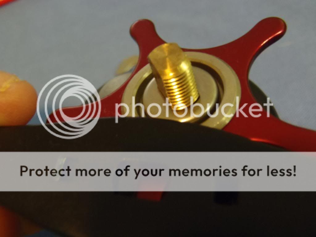

Lightly smear some grease on the threads of the stub for the cast control knob. Also add a tiny dab of grease on the point of the clicker spring.
Carefully thread in the cast control knob. You can choose to assemble this at a later stage (before you fix the handle) together with the Black T-shaped spool tension pin. Doing it later will make it easier to fix the sideplate to the frame.

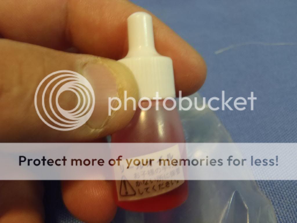

If you do not have drag grease, do not try to use your regular reel grease to wet your drags. You will get jerky drags instead of getting them smooth. In that case, it is better to use your drags dry, or go get a proper drag grease. Daiwa, Shimano and Cal's (maker of smooth drag and carbontex) drag grease are available in our LTS (Local Tackle Shops).
Use Drag Grease For Wet Drags
This is what Daiwa's Drag Grease looks like. It is very thin, compared to Cal's Grease.

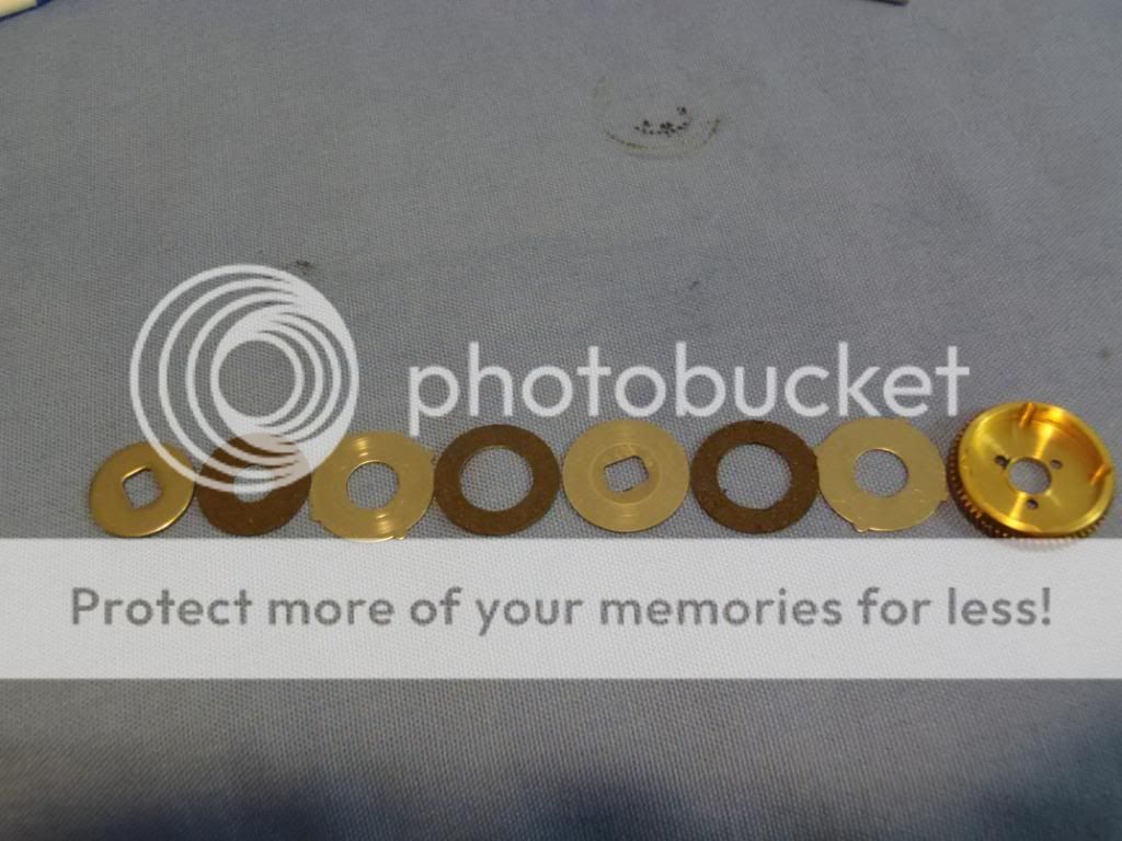

Drop in the smallest carbon washer and seat it flat against the plastic ratchet of the freespool mechanism.
Installing The Drag Stack
First piece of the drag stack is a stainless steel Eared Washer. Slap on some drag grease after you've dropped it in.
Note: Do not grease the underside of this washer or the inside of the Main Drive gear. Doing so may render the eared washer stuck to the Main Drive gear and very difficult to remove without the aid of compressed air.
There are 2 pieces of big Carbon washers. Drop any piece in next.
Slap on some drag grease.
SOME drag grease... NOT butter it thickly like kaya toast
Mop up the excess.
Drop in the stainless steel washer with a square key hole.
Try to wipe away excess grease and stay tidy
Drop in the 2nd piece of big Carbon washer and slap on some drag grease.
Mop up the excess
Drop in the 2nd piece of Stainless Steel Eared Washer and slap on some grease.
Mop away the excess
Drop in the small Graphite drag washer and slap on some grease.
Drop in the thickest Stainless Steel key washer.
Clean away excess

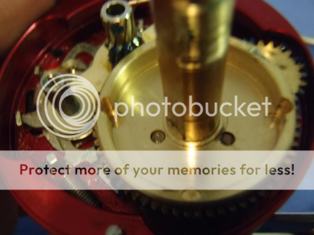

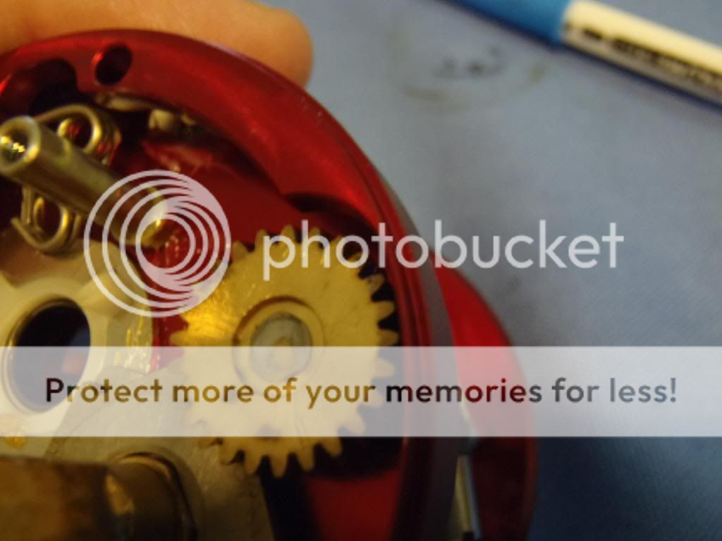

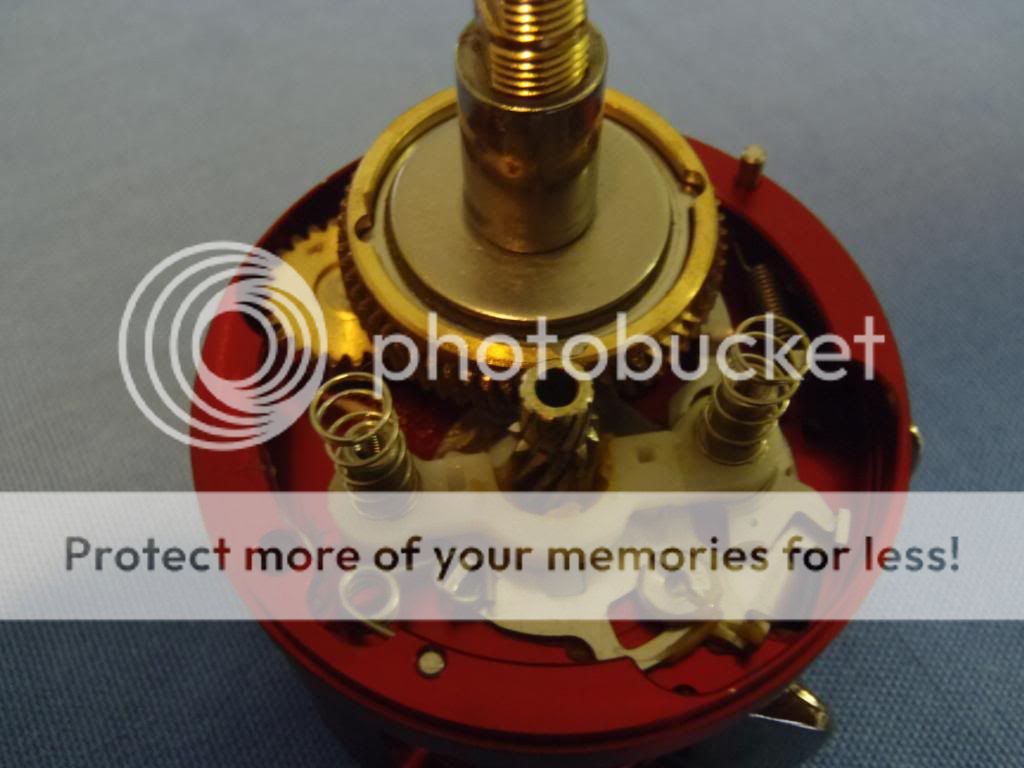

Greasing the Drive Train
Use lithium grease and work it into the Main Drive Gear's teeth.
In this old pic, I used red-colored lithium-soap SureGrease. I now find it insufficient if it gets wet as the water will emulsify the grease. I now prefer to use Cal's Grease which works both for drag and for the drivetrain.
Clean away any excess from the top and bottom faces of the Main Drive Gear, taking care not to contaminate Drag grease with Lithium grease.
With key washers of the drack stack aligned, drop the Main Drive Gear with Drag stack down the Drive Shaft and mesh with Pinion Gear.
There — the main drive is sitting flat on the bottom graphite washer and meshing with the pinion gear
Work the Main Drive Gear a few rounds to squeeze excess grease into the Pinion Gear.
After that, wipe off excess grease.

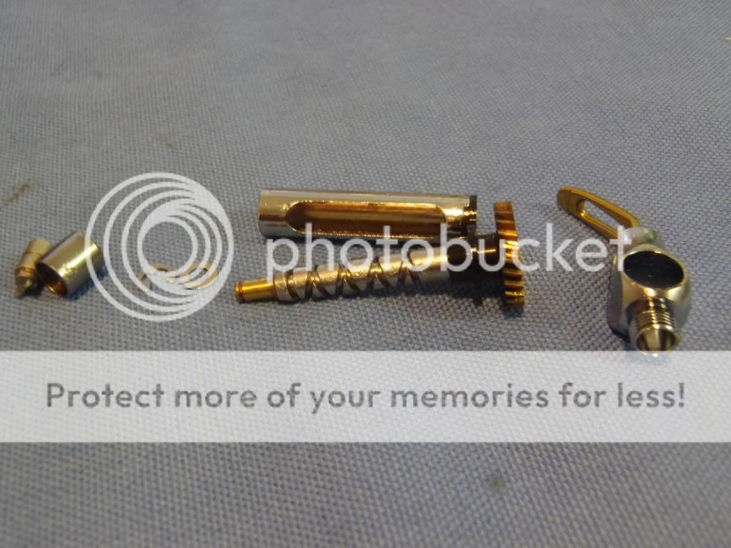

Installing The Parts Of The Handle System
There are 2 ends to the Roller Bearing Clutch's inner sleeve. This end should go in first.
This end should be facing the handle.
This is what it looks like installed correctly. You can choose to install this now, or after you had fitted in the right side cover. Installing it later makes it easier to fit the right side plate for a beginner.

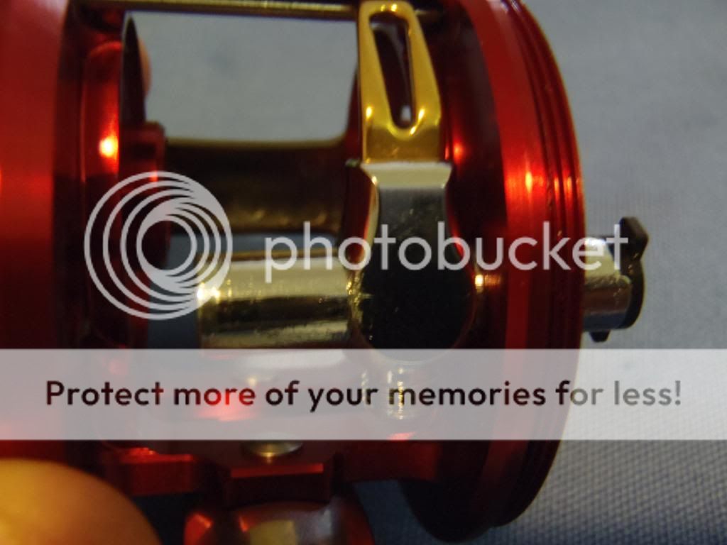

For corrosion resistance, you should grease the metal frame and sideplates with a marine grease, especially at this spot where the nose piece meets the frame.

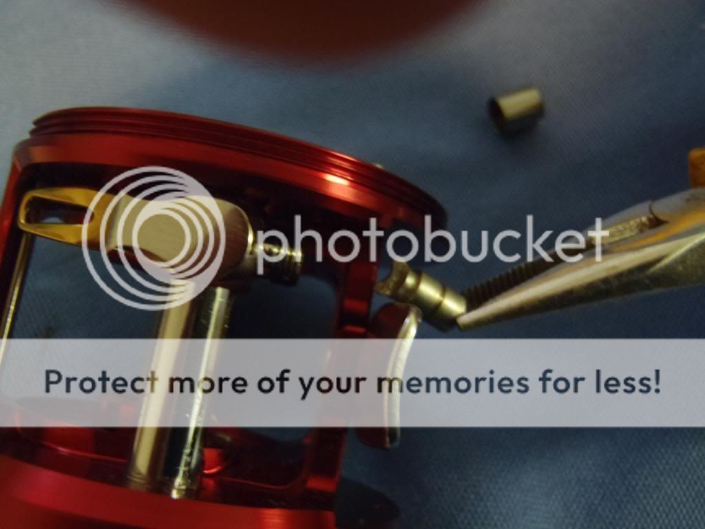

Thread in the long screw that serves as the levelwind guide rail.
Tighten. The more observant of you might notice that I'm holding onto the screwdriver bits instead of using a proper screwdriver. I choose to do it this way as it has less grip, thus preventing over torque-ing screws.
The right side plate is not fully secured yet, so do not let go of it or the springs inside will push it apart.
Dab a bit of grease on the screws and work it into the threads.
Remove all excess grease and carefully thread them into the corresponding holes, taking note that there are 2 short and 1 long screws. The long one fits into the bottom hole. Do not tighten completely till you have completed alignment.

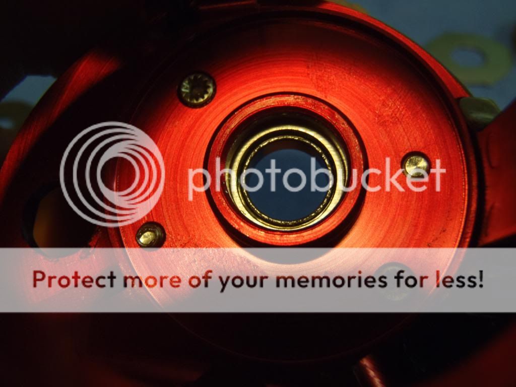

The big Drive shaft bearing should have its seal removed and be greased for maximum protection. But if you like a light feel on the crank, oil this bearing with CorrosionX and always rinse and re-oil after use in the salt for longevity.
UPDATE 2012: There are now full ceramic bearings available in the market. These are corrosion proof and are ideal bearings for this purpose. You only need the cheaper Zirconium (White) bearings for this placement.
Drop in the big drive shaft bearing and work it into its housing by pressing while rotating the drive shaft.

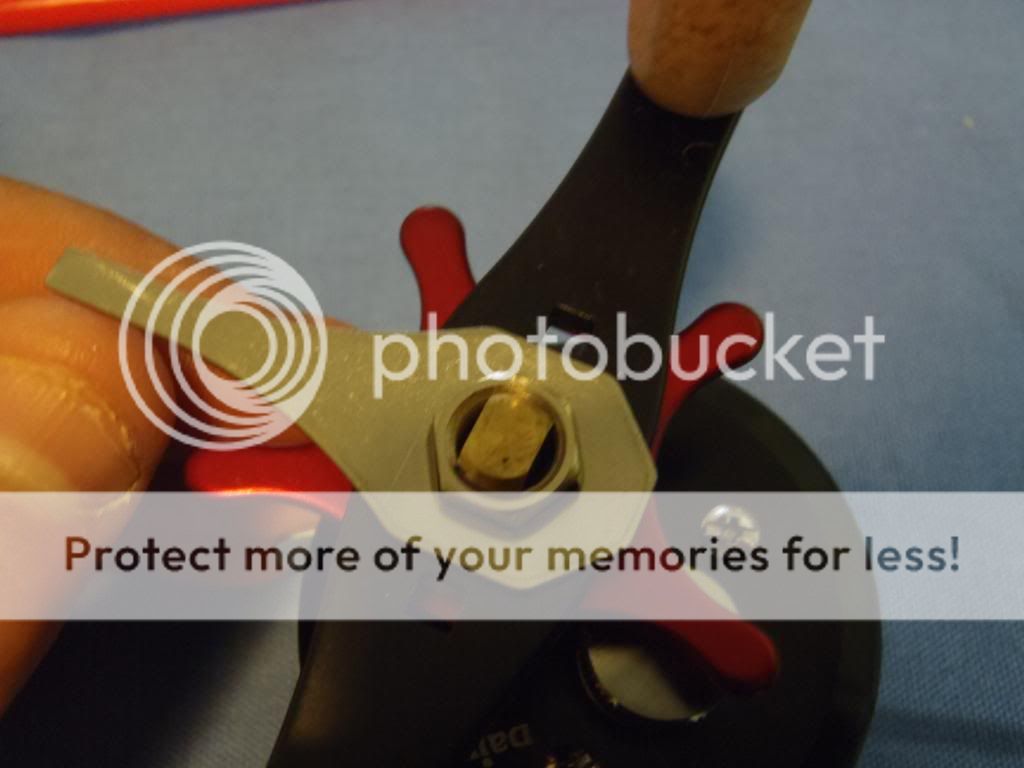

Thread in the handle nut carefully.
Synch down the star drag tight before tightening the handle nut.
Tighten the handle nut, taking care not to over torque and taking note of the nut's position in order to fix in the locking tab.
Drop in the locking tab with its curved side facing down.
Then lock that locking tab in place with the locking screw.

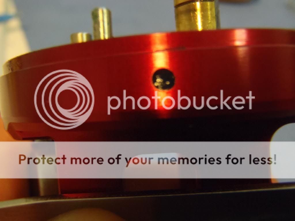

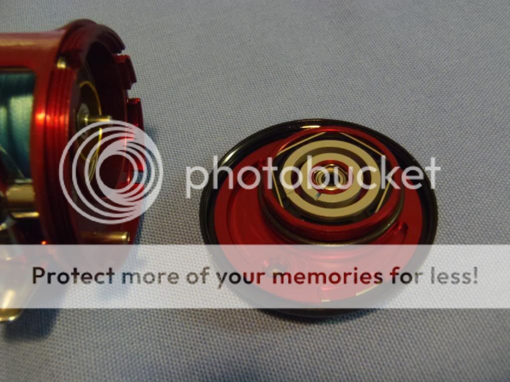

Fixing in the Left Side Plate

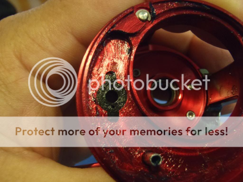

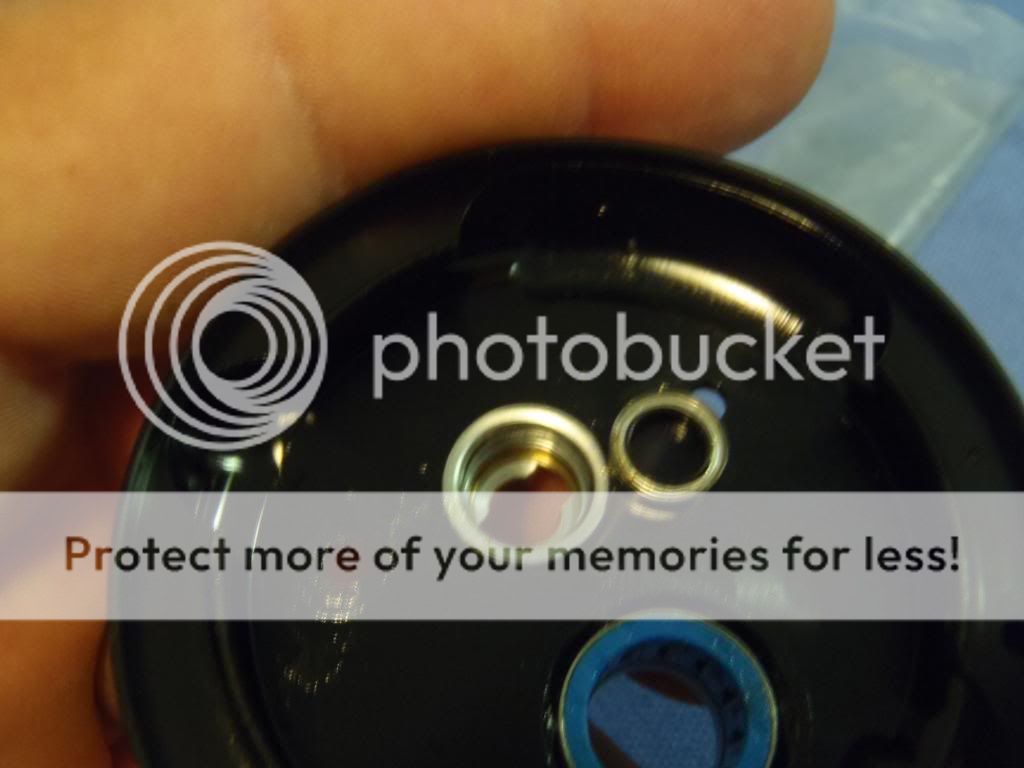

Clean the Ball bearing housing on the left side plate of oil and debris. There is a felt washer at the bottom that tend to soak up water. Clean that up thoroughly.

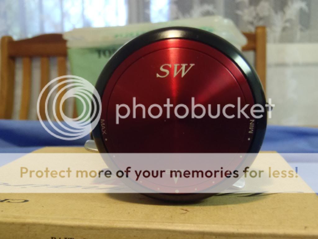

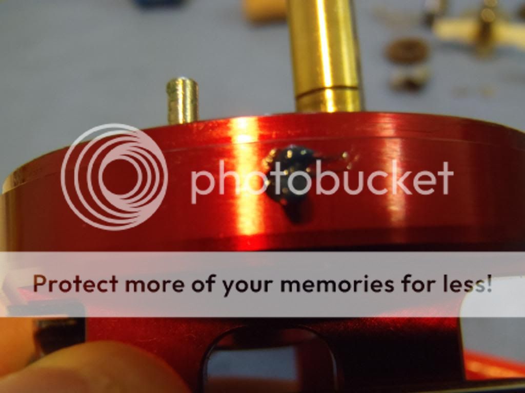

There is no need to remove the magnets as it does not corrode. However, my 14-year old TDX103-HVA had its inner magnet ring come off from the plastic housing. When that happens, you find that the braking is either full on or full off. (It was full on for me).

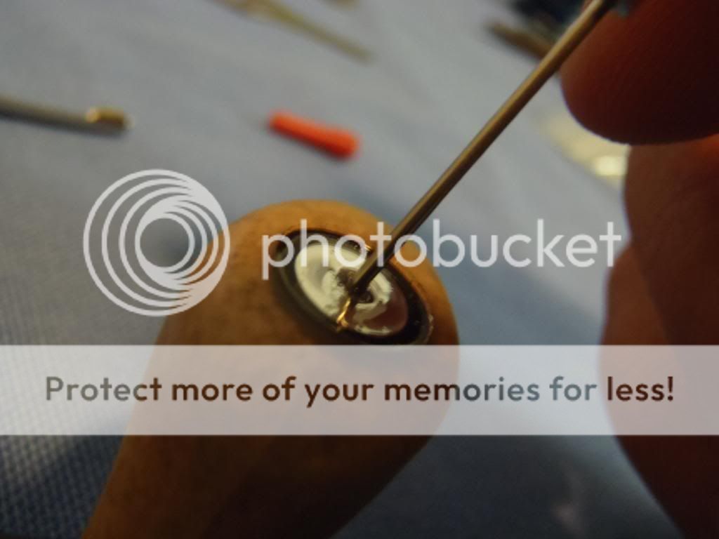

To fix this, I turned the braking knob to max, aligned the line marking on the plastic bearing housing, the inner magnet with the outer magnet and glued the inner magnet back with some contact adhesive.

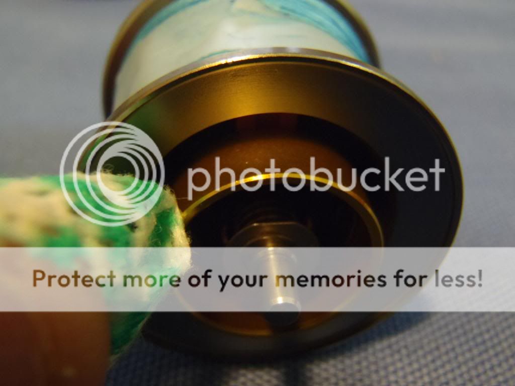

Oil the small spool spindle bearing with a low viscosity oil and fit within its housing in the centre of the magnets of the left side plate.
Do not over oil spool bearings as it will affect casting of small lures. If you had dropped more than 1 drop of oil, try to dab away excess with a tissue paper. If you have a can of compressed air, giving the bearing a blast will blow off excess oils and cause it to spin at high RPM. But do not spin dry bearings as it will cause premature wear.
I personally prefer to remove the bearing shields and run them open. I can clean the bearings more effectively this way, and also it seem to give me better spin times. My ABEC7 bearing for the left sideplate can free spin 45 seconds when effectively degreased.

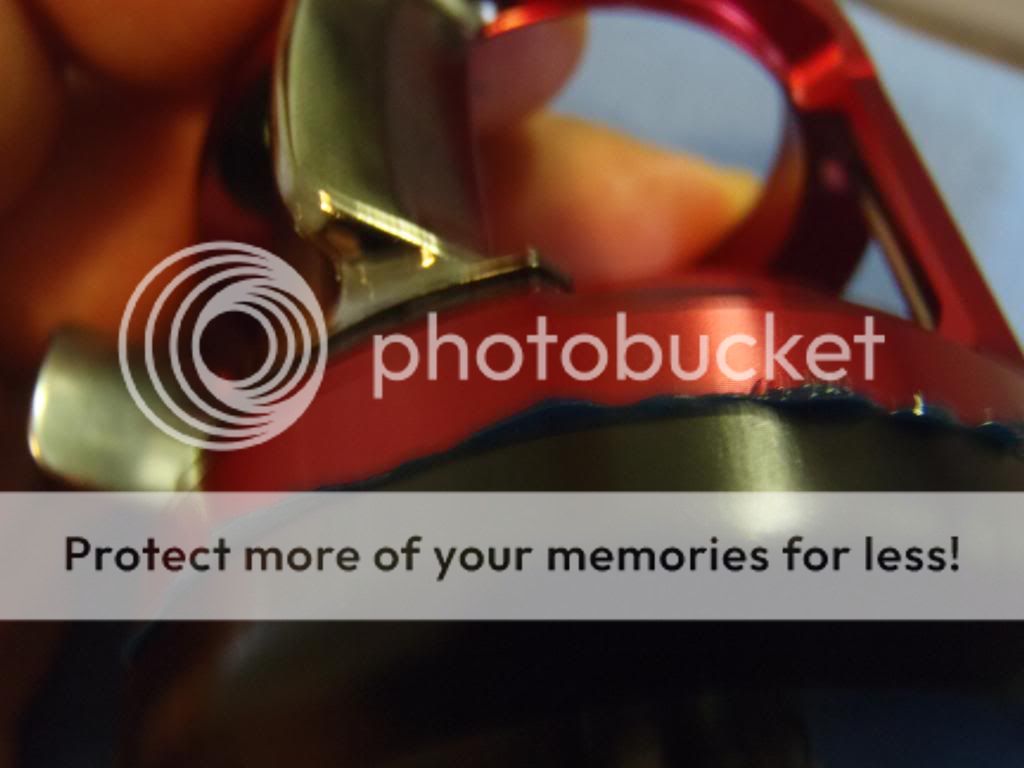

Carefully slide in the retaining circlip.
Next, lightly dot each end of the spool spindle with low viscosity oil and reassemble. Sorry, wrong picture! but you know where is the spool spindle right?
