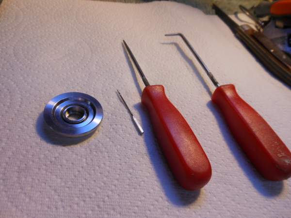

The tools required.  I'll use two small picks and a sewing machine needle.  My wife keeps wondering why she can never find a needle when she needs one.  I've found these to be the best implement to remove bearing snap rings of various sizes.
DSCN0400
It's a simple task to force the needle between the retaining ring and the bearing housing.
DSCN0401
