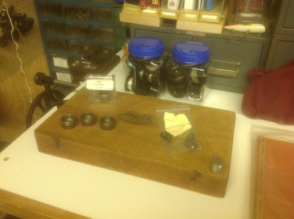

Good morning guys, I'm having a brain freeze. Ordered HT 100 Drag Washer Kit #6-114SP to upgrade an old Penn Black 6/0. It's the 5 stack plus metals. Have the steel main gear in it but the groove for the eared washers is not cut to the bottom of the gear. The only way to make it all fit is: CF-keyed-CF-keyed-CF-eared-CF-eared-CF-keyed-felt-cap. Is it OK to stack the 2 eared this close or not. If I put eared under the felt it doesn't catch the groove on main gear. Also, when it's stacked in side plate it's very low compared to the stock 3 stack which sits flush with the side plate. Thanks for the advice in advance. See pics below.                                             Richy

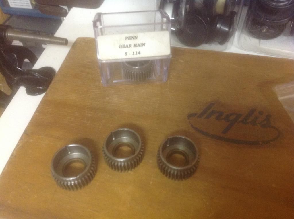

Sorry guys, I forgot the gear pic.

I personally have never seen a gear as that one, you will need to use a dremel and cut the groves a little lower, in your case a lot lower. Changing orientation with the washers won't work, you could make it work but will lose drag numbers. The best solution is to use a dremel or anything else you're comfortable with.

I'm with Sal, Never seen a gear like that! That is  the problem when working on these old reels. Sometimes we run into obstacles. Your gear should look like this.

This is the layout of that stack Richy. With the correct gear, It should fit perfect in your Dad's reel. ;)

Hey guys. Thanks for all the input. Fred, thanks for the offer. My Dad has another bucket of old reels I'm gonna check thru and might get lucky with a normal gear. If not I will get in touch, thanks. Shark Hunter I'm posting a pic of the original stack with 3 fat fiber washers and 3 thick metal. On top is a felt #140-114 and collar/cap #136/114. On top of the collar/cap is a spacer then a thick belleville washer then the star then a thin Belleville then handle. The side plate shows Penn 6/0 only. No 114 or 114H anywhere. The drags are removable from the side plate just taking the handle off. That's how old it is. Also when I put the HT100 kit in, even with the wrong stacking order to make them fit, it's 1/8" lower on the side plate than the originals. Don't know if that matters or not for the performance but I assumed with the new kit it would match the height of the original.
