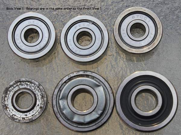

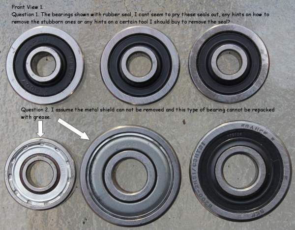

QuoteI do have a couple of questions for you though as I played more with all the bearings I need to do.  See pictures to help answer questions.
Front View 1.
Question 1. The bearings shown with rubber seal, I cant seem to pry these seals out, any hints on how to remove the stubborn ones or any hints on a certain tool I should buy to remove the seal?
Question 2. I assume the metal shield can not be removed and this type of bearing cannot be repacked with grease.
Front View 2.

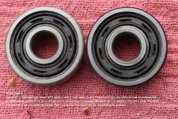

Question 1. The bearings shown with plastic seal, I cant seem to pry these seals out, any hints on how to remove the stubborn ones or any hints on a certain tool I should buy to remove the seal?  BUT it appears the slots show the metal retainer ring for the bearings below them, so maybe this style can be repacked with grease?

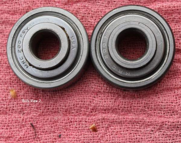

hi, mike.  i did some google searches.  it looks like some of these bearings have a race that is made of a thermoplastic material, rather than metal. what you are looking at on the top row of bearings is actually the back side of the race.  i have seen that in some cheaper bearings used in fishing reels.  they work ok for slow, heavy load, applications.
front view 2 might be the same situation.  i think you just have a funnly looking shield, but what you might be looking at might actually be the race.  either way, all the other plain steel metal shields are all the "press in" types.  to remove them, you have to dig in with a sharp pointed tool.
but mike, you don't have to remove the shields.  that is the whole point of the bearing packer.  stick the bearing in and start pumping the grease gun.  grease is completely forced through the bearing, from one side to the other.  you want to leave the shields on anyway.  that way the shields will hold in the grease.  and as far as greases go, you are looking at a high speed application, not like low speed low temp applications in fishing reels. you need a high speed/high temp grease.  i believe that a high temp automotive bearing grease would work best for what you do.
